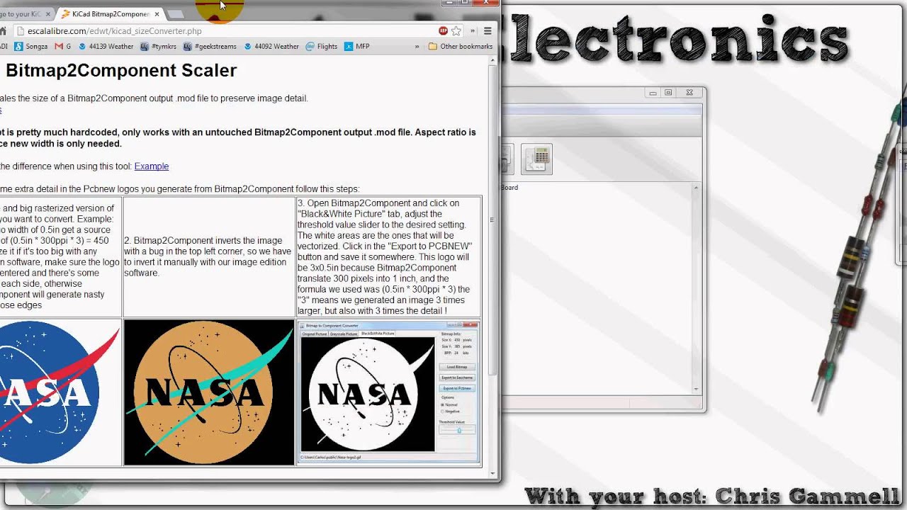

For most regular fabs vias are just that:metallized holes, they don’t add anything on top of coppet layer.
Making footprints with odd geometries can be tricky, but is doable. In your case, you might be better off making a PNG and then importing that to the copper layer.
Here is a series of videos about making footprints manually in the module (footprint) editor:
And here is a video about importing a bitmap and using that:
The second video is about importing it to the silkscreen layer but it also shows how you can change the layer to the top or bottom copper. You might have better luck with this since you’re trying such a complex pattern.

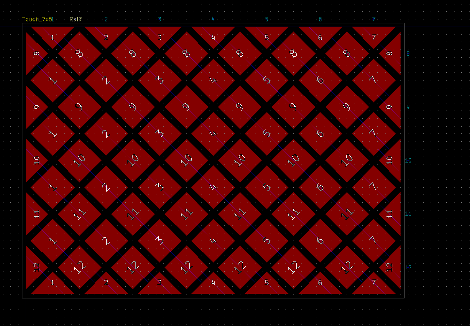

Hi @riqi, did you end up making the PCB for the touchpad?
I’m following your path exactly, and planned to use Kicad to create a touchpad for the MPR121 using the PCB design in the application note AN4600 from Freescale Semiconductor on the MPR121.
If you’ve already made the PCB design in Kicad, could you share it with me? It would save me a lot of time… :slight_smile: Thanks.
Its not a hard footprint to make, You would create a square pad of the size you need, rotate it 45 degrees, then keep on adding them to the final pattern shape, you would then number the pads according to the rows / columns, e.g. every pad for column 1 is pin 1, this way when your laying it out the rats nest and unconnected count will show how you need to wire it up.
Touch_7x5.kicad_mod (9.5 KB)
