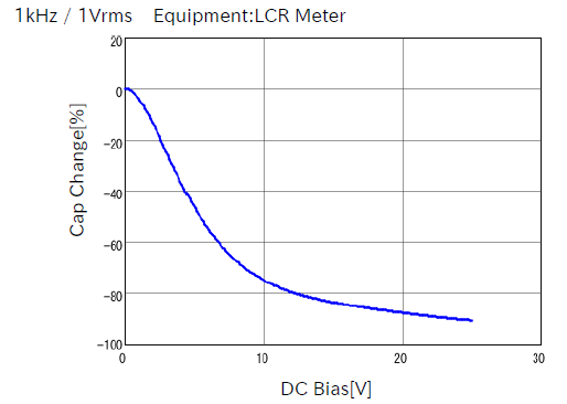

There is a drawback at this small size, regarding DC behaviour (essential for decoupling operations).
The XR5 dielectrics used in 0201 MLCC (no X7R that I know of) have nothing in common with the good ol’ 0603 X7R-X5R, regarding C vs V.
X7R is indeed based around a temperature spec, but there is (was?) an “implied” V vs C behaviour that don’t seem to hold here.
Every 0201-X5R-100nF 16V to 25V I’ve checked loose over 80% of it’s capacity at 10-12V.
Looks more like a Y5V.
(Murata, TDK, EPCOS and many “much less known but high volume” Chinese/Taiwanese manufacturers).
I was surprised to see that these 0201 MLCC begin to be affected @3.3V (-50% @5V !)

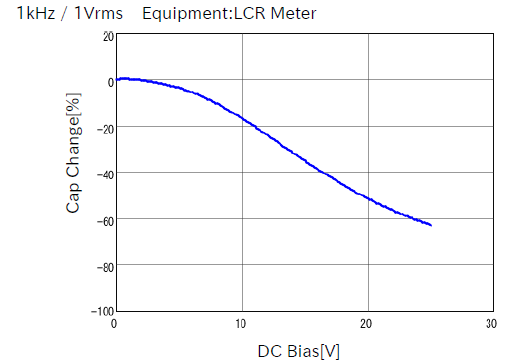

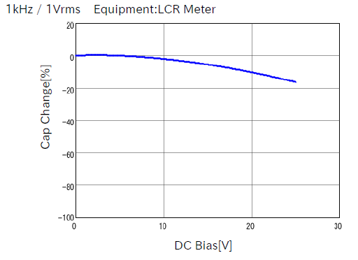

Murata specs (other brands are similar) :
100nF-X7R-25V 0603
100nF-X7R-25V 0402
100nF-X5R-25V 0201
Yes, surprised me too.

Those are some very disturbing graphs!
Dale
