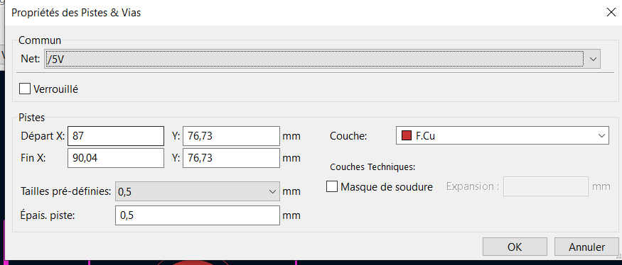

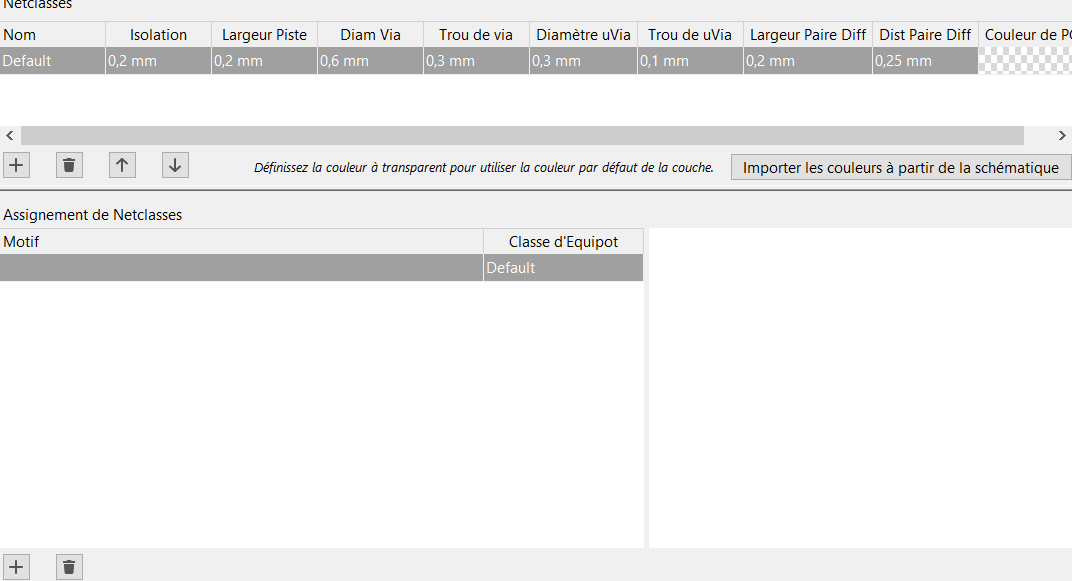

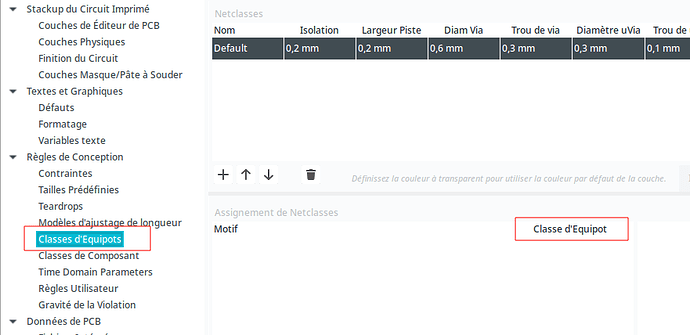

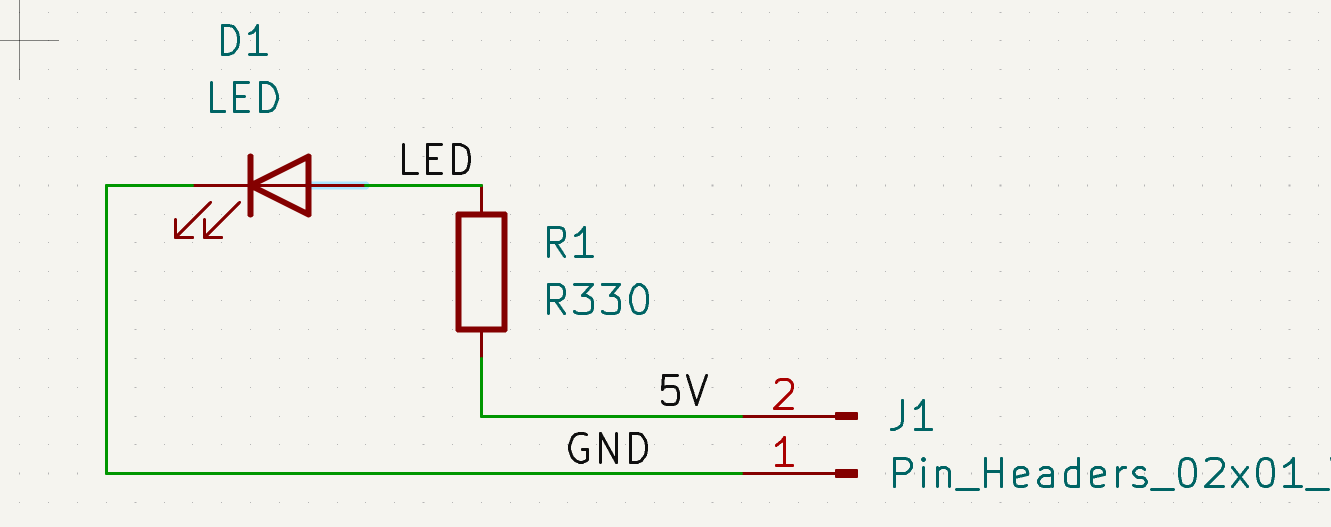

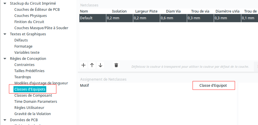

In my schematic (see photo 1), all pads are connected and have nets assigned. The nets also appear correctly in the PCB editor (photo 2). Moreover, in the pad and track properties, the nets are clearly visible (photos 3 and 4).

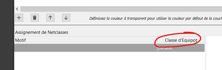

However, in the Equipotential Class view, nothing is displayed — the list stays empty (see photo 5).

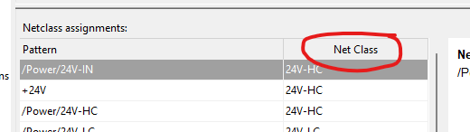

Netclasses need to be created, they don’t automatically appear.
BTW don’t make this circuit, it will destroy the LED.
I’m not sure what a “equipotential class” is, but if you’re talking about netclasses: You either have to assign them in the schematic or define rules to automatically derive them from classes

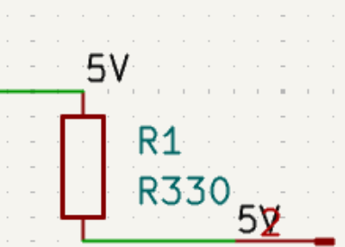

It is a test circuit, why the led will be destroy??? I put a 330 ohm resistor… .

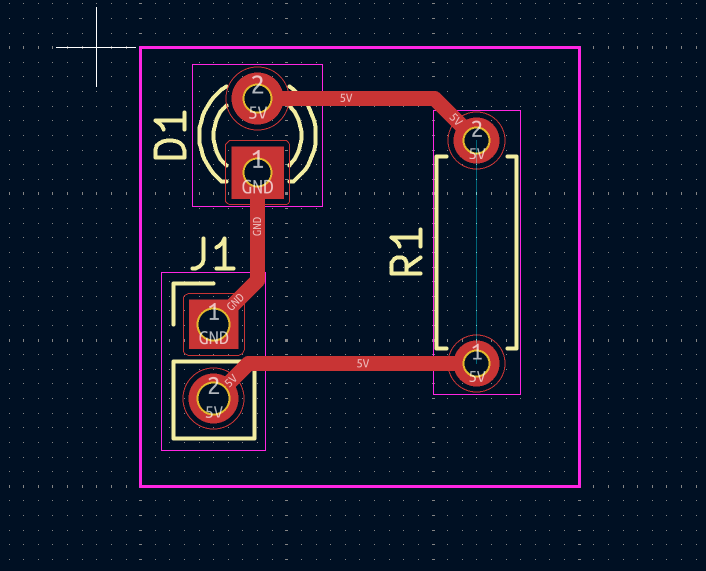

It will only destroy the circuit if they connect all pads that the ratsnest suggests based on the schematic. The current PCB is fine - because they ignore the ratsnest

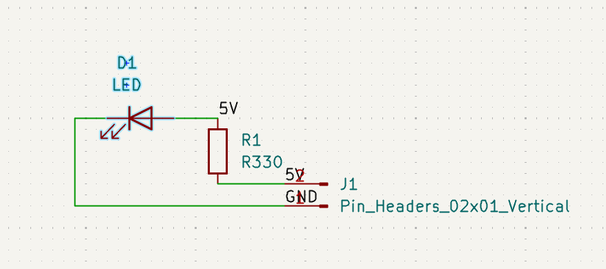

Because you assigned the 5V net on both pads of the resistor, shorting it. You ignored that when routing the PCB, which makes it work. But your schematic has a short
According to the schematic you are applying 5V forward voltage to the LED.
At the moment you have only one netclass, Default. You don’t have to assign nets to Default. If KiCad doesn’t find a needed value for width, clearance etc. in some other assigned netclass, the value in Default is used. Assignment is useful only after you have more than one netclass.
Did you read the manual?
adding to what @eelik said: While netclasses are nice and helpful, it is nothing you have to worry about for basic PCB designs. It is quite useful once your PCBs get loads of components on them
You have made a (common) beginner mistake.
The label 5V doesn’t mean “5 volts” for KiCad. It’s just a name for the net. All texts in the schematic are only text, KiCad doesn’t interpret them as numerical values. For different kinds of net labels the same text means the same label → same net, even when without a visible connecting wire.
Because the same net name is used for two wires, KiCad connects them together. The upper one of course has actually smaller voltage, so it would be natural to rename that one to something else.

What are “Equipotential Classes”. Is it something new in V9 that I don’t know?
Equipotential suggest that it would be collection of nets having the same potential. Nets have the same potential when they are the same net or are connected with net-tie.
Maybe . . .
This is just the natural reverse translation of the UI’s French label (some of them anyway, many other instances say just “netclass”):
IMO even if you don’t know that, it’s pretty clear that the OP is talking about netclasses, since they’ve screenshotted the netclass dialog.

You put R330 in the schematic, and that is normally interpreted as 0.330 Ohm, not as 330 Ohm. For more background info see RKM code on Wikipedia.
