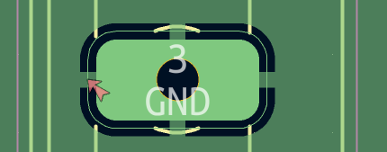

Thermal relief connection to zone incomplete (layer In1.Cu; 5 spokes connected to isolated island)
Hi. I’m getting the error
“Thermal relief connection to zone incomplete (layer In1.Cu; 5 spokes connected to isolated island)”
Minimum thermal relief spoke count is set to 2.

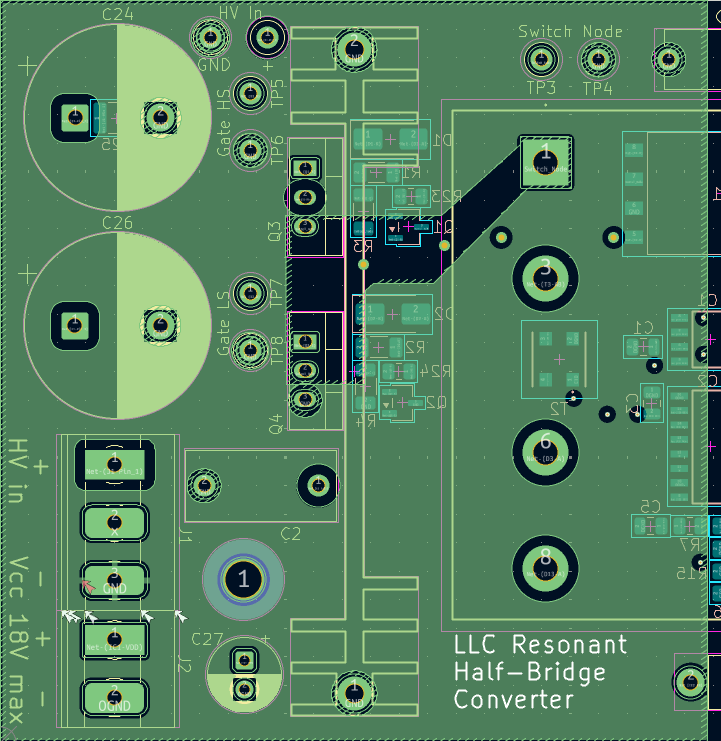

This is a ground plane with a single connection to ground. All other potential connections to ground are excluded using “Keep out zone fills”.
I can’t find an island and I can’t find a fifth spoke. Changing Pad Connections to solid gets rid of the error. I have an identical (I think) ground plane on In2 and there’s no problem there.
I don’t know whether it will help, but here is a screenshot:
Any suggestions much appreciated!
The whole plane is an island.
With a simple test (1 net GND, 1 zone for that net, 2 1-pad footprints for that net where 1 footprint/pad is isolated with keepout area) I can’t get that message. So, there may be something else going on.
What is the zone property “Remove islands”? Set it to Always if it’s not already, and re-fill. Does something else happen?

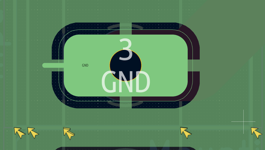

I can replicate. V9.0.7RC1 Win10. Odd. Smells bug like. As a workaround, if you add a short route segment into the zone overlapping the alleged 5th spoke? then refill and rerun DRC, that error clears.
