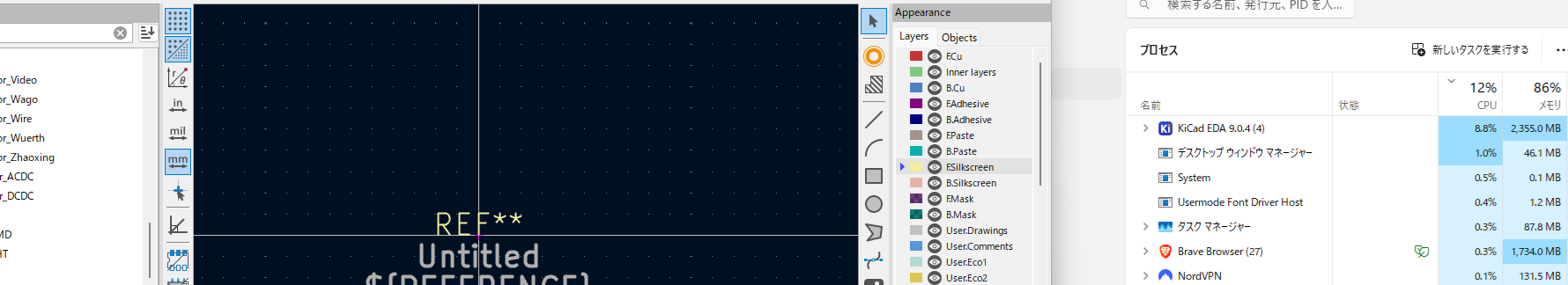

When I opened foot print editor, The resource of CPU was used by the task permanently. Though I waited for sometime, But the resource wasn’t reduced. It was about 6 or 7% of the CPU. What has happened? This occurs only when the window is selected. Now I am writing this with web browser window, It doesn’t occur.
The version is 9.0.4, release build.

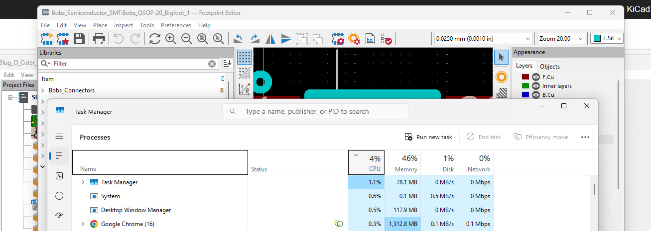

I do not see anything like that.
Maybe post the footprint file you were working on? Also a description of your computer.

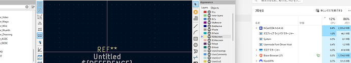

The phenomenon has presented again.
Here’s how to reproduce it:
Open the foot print editor.
Tap the New Foot Print icon.
Choose the Draw Lines icon.
That’s all.
It was increasing cpu usage.
It’s probably related to the footprint library change monitoring.
It’s monitoring if libraries are changing externally. Mainly meant for people working with multiple people over network drive shared footprint libraries.
Now I tried but not represented.
