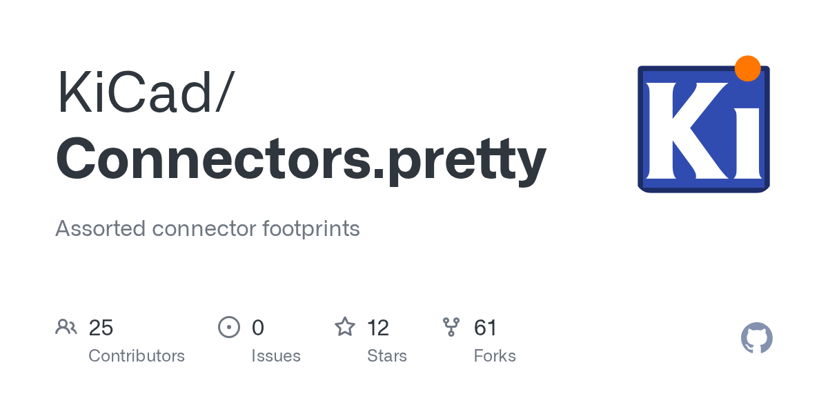

The 3D model looks like a standard header pin, but undersized. Those need a 1mm hole. If this KiCAD footprint specified a 1mm through hole, it would match up with real parts. Did someone just guess at the hole size when creating the footprint? Grrr. Should I submit a bug?
Amphenol 68001-101HLF - 1.03mm ± 0.08mm hole size
Yes, but at the correct place.
Open an issue at the github repo of this library.
Or change the footprint and submit a pull request.
Submitted bug: https://github.com/KiCad/Connectors.pretty/issues/60
