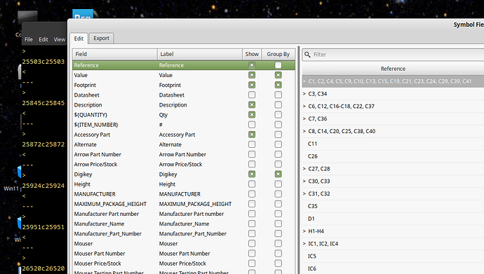

In Symbols Field Table is fantastically useful.
But there is one quirk. The tool opens with two panels, one with tabs labeled edit and export, and the main panel that lists the components.
How do I close that edit/export panel when I am not using it? (It takes up too much screen to leave it open all the time.)
There is a divider in between those two panels so you can drag it a bit to the left. But as far as I know the left panel can’t be closed. It’s minimum width is also still quite wide.

Let see if I can explain it better.
Here is my Symbol Fields Table window
Notice that in the panel on the right, the first column is Reference values (C1, C2, etc) and the right most column is the Digikey numbers that I selected. The panel on the left is the selection for which columns to show in the panel on the right.
The problem is that the window in total is much larger than one screen.
That means that I am constantly scrolling horizontally to see the reference number, foot print, description, etc and the last column, the Digikey number.
That situation is prone to creating errors.
What is more, is that that window on the left is NOT something that a users needs to have open constantly.
Typical use case is that a user might configure which columns to show, perhaps once or twice in the entire history of using the software.
So, having that panel on the left open all of the time, (a) is a waste of screen space, and (b) creates a situation that foments errors in design work.
Okay, is it more clear now?

regarding the visual change of the left panel to hide the “columns” area:
  • I understand your wish.
  • I’m not sure it will help much. It will increase the available horizontal area by ~15…20%. This is a small improvement, not a gamechanger.
  • I’m not against the idea, I’m undecided. My compromise would be to allow the vertical panel divider to go more to the left side, so the left column could be thinner.
  • if you want, open a bug report at gitlab, I will mark it as “feature request”
Another approach would be to move everything to one panel, three tabs.
And still another approach, open the configuration controls in a different window.
That 15-20% is huge for this problem, and it is actually more like 25%. (There is one column in my display that is not needed. )
The way I work around it now, is to shift the whole thing so that the left side is off screen. But that is a clumsy workaround at best.
What determines the minimum with of Field, Label, Show, Group By part of the view. Some programs let you slide such things so far the’re just a handful of pixels wide.
“Show” and “Group By” width seem to be determined by headers. With abbreviated names (for narrow width) they can be nearly as narrow as the checkboxes. “Field” and “Label” columns are very similar. On narrow windows one could be completely hidden, and the other be allowed to shrink further.
Combined, this could shrink the minimum width from the 430 pixels it is now, to about 150.
