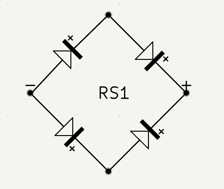

Well lines yes I rotate. But when already finished a component and I want to reuse it at an angle: it seems impossible.
I have to do it in SVG. But KiCAD is horrible with SVGs.

I want these drawn exactly so. The Full rectifier: I did use the SVG but it was a pain in the **ss. the second I want to do it as it is shown in the figure below the screenshot.
You can’t - use alternative symbols or draw diode straight, not at an angle.
For me it is really exotic need until you don’t create a schematic to make PCB but schematic for example to be used in book. But then it need not be done in PCB design program but in any graphic editor where you don’t have angle restrictions I think.
If this bridge is single part than you can draw symbol as you want, but if 4 separate diodes just place them vertically or horizontally.
All my schematics are single sheet so I prefer to have as small symbols as possible. My diode bridge symbol looks like this:

The bridge rectifier is easy.
All you need to draw is the five lines shown by the green arrow.
The rest is L to R & R to L area selection, Duplication, Rotation, X & Y Mirroring.
The voltage multiplier is a bit more difficult. Because the diodes are on 60 deg. you need to create two diodes by hand. To get them the same you will need to use the measuring tools in the select menu.
Once the two diodes are made, Duplicate.

The way I achieved 45 degree rotation of symbols is by using an alternate body style. So now a resistor symbol has 2 body styles - normal and rotated by 45 degrees. The rotated symbol is made so that the pins still snap to the 45 degree grid. Here’s some examples:
You can find these symbols in a newest release candidate for my library here:
If you want to replicate this yourself, you need to set the pin length to 0, because you can’t rotate pins by 45 degrees either.
