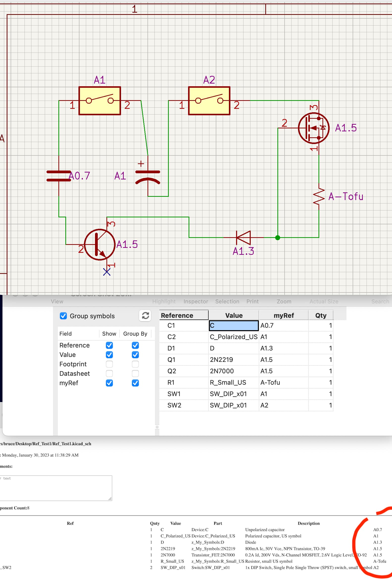

Thus, I dug-up some of my earlier BOM tweaking and related files - I created half-dozen in v5 and they still work in v6.11. I did NOT spend time fussing with making their output’s pretty… but, you’ll get the idea…
So, here’s the scoop by Example:
• I created dumb schematic (not a real circuit - just wanted some parts on it)
• I set the Ref/etc to Hiden
• I Added a Field for each part (called ‘myRef’ ) and set some values
that indicate Schematic Grid-Location (I should have spread them out but, you’ll get the idea)
• Ran DRC check (no problems, no warnings)
• I generated a Netlist
• I generated a BOM (CSV and HTML) I used my custom CSV/HTML but the default should also work)
• I opened the CSV in LibreOffice (spreadsheet) and set desired items
• I opened the HTML in Firefox
ADDED: Snippet of Netlist
Summary: Easy enough to get something useful if willing to invest a few minutes to learn how to tweak the .py files and use them…
Screenshots show various aspects… (Axx crudely refers to Location on schematic)
Schematic, Symbol-Field-Table and Firefox with HTML-Bom
CSV loaded into Libre’s Spreadsheet
Snippet of Netlist
