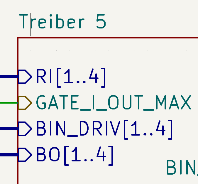

              Hey,
It would be nice if i could directly merge them into one bus signal when they come together and instead of having x seperate busses like this:
              Directly merging busses is currently not possible.
                Detzi
                    October 23, 2023,  7:49am
                  3
              Thanks @mf_ibfeew . Is that generally not possible or just because of the way i implemented the buses in my schematic?
              Merging busses is generally not possible (current situation, so at least kicad version <= v8).Schematic Editor [Feature request]: Would it be possible to add an easier way to make bus branching? (#13673) · Issues · KiCad / KiCad Source Code / kicad · GitLab
Regarding your bus-drawings: this looks ok, you have drawn simple vector busses.
