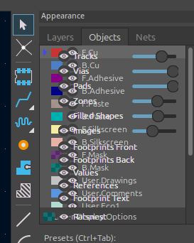

Strange overlap behavior in appearance panel (PCBnew)
Has anyone else experienced this behavior?
Layers panel selected (everything okay)
Objects panel selected (text overlapped)

Being warned at launch of known issues that depend on drivers or OS versions could reduce the number of posts like this and save time. :slight_smile:
We don’t know which driver versions cause this.
Replies in the issue suggest it may be caused by incorrect OS update process or other configuration, since it doesn’t reproduce on a clean OS install. And it appears not driver-dependent.
Indeed I’ve installed kicad v9 in an upgraded Linux Mint from 20 to 21. Not a fresh install.
I suspected that it might be something related to this upgrade, but since I was able to do it without any problems (and without any errors), I wanted to ask in the forum to be sure. I hadn’t seen any messages related to this issue. Sorry if I caused any inconvenience.
It is clear that this issue does not appear from a fresh Linux install and it is not driver dependent but…
I have seen that this is the only panel that fails. The rest of the KiCad panels/menus work as expected.
Switching between Layers and Nets panels works fine without overlap.
Switching Objects → Layers and Objects → Nets also works fine
The panel visualization fails (overlap) when switching Layers or Nets to Objects.
I find that strange. Is there anything that can be improved to fix this issue regardless of whether you start with a fresh install or not? This would prevent unnecessary posts like mine :wink:
