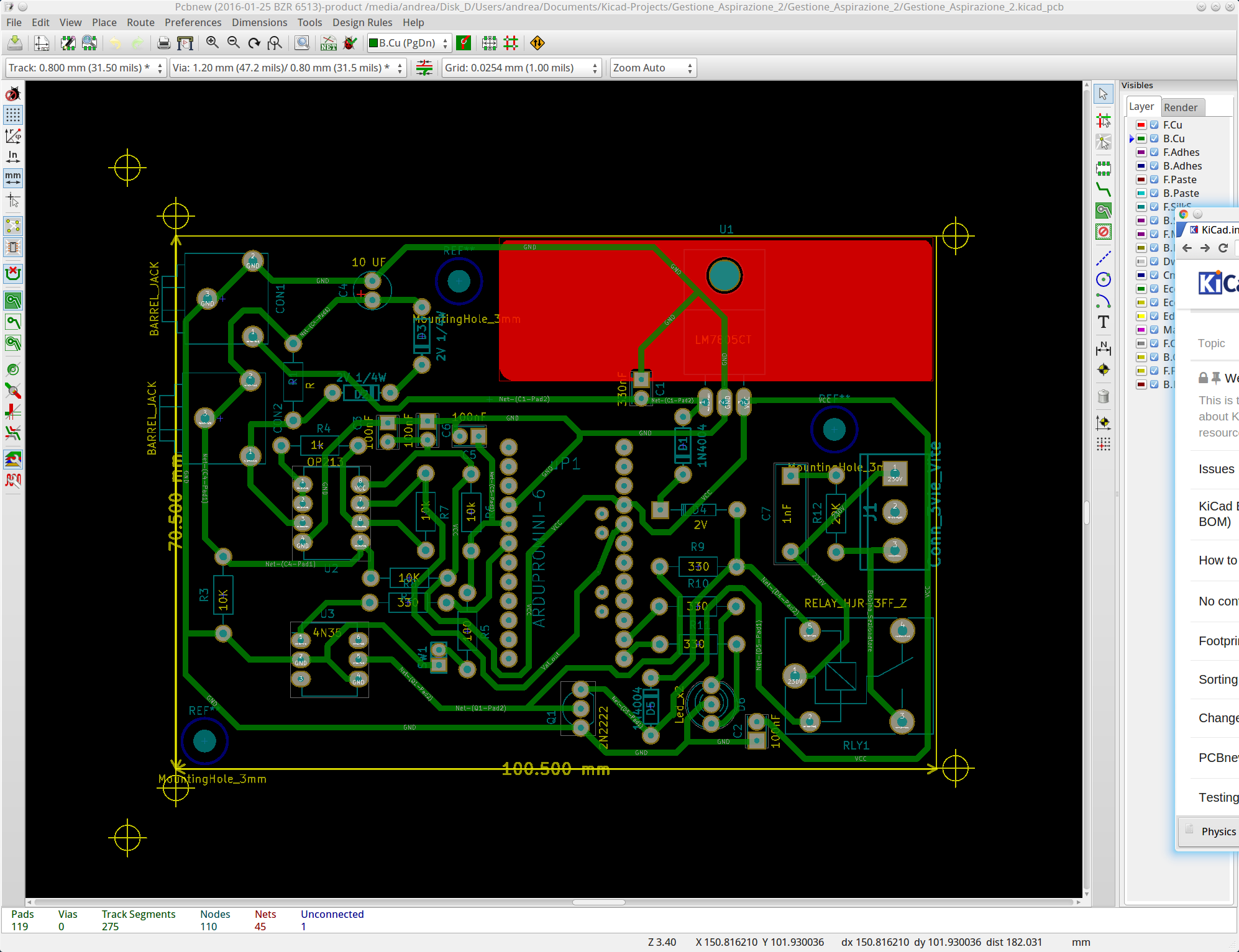

I’m running version 6513.
I edited the attached board to adjust the distances among the tracks and change a couple of footprints. At the end of the editing I noticed that the program shows that I have one unconnected net, but if I run drc no unconnected net or pad is pointed out.
What’s the difference among the checks that pcbnew and drc do? This information can help me solve the problem, as up to now I’have been unable to find the error, if any.
From painful experience, it appears that the DRC will assume that overlapping tracks are connected - after all, there will be a conductive path when a board is made, whereas pcbnew counts the nets where the track segments are not properly joined.
Unfortunately, the rats nest for these improperly joined segments is often not visible, even at the greatest zoom level.

@Martin_Layley So, assumed this is the difference (and I guess you’re right, as I had the same feeling), I can simply ignore the pcbnew message and rely only on the drc check result? Any negative consequence?

Maybe the mounting hole of the 7805 ground pad ?
No, I didn’t touch that. The problem appeared after moving other tracks to have an uniform clearance among them.

GAL has some issues with unconnected nets for some reason, but the dev who did much of the GAL work tends to fix them fairly quickly.
Rely on the DRC… it is correct.
