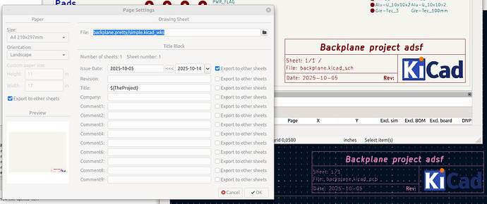

It would be nice to have a single project title block which then syncs down to the schematic and PCB editor.

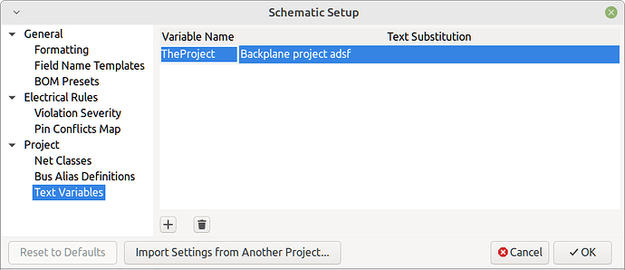

You can do this with text variables.

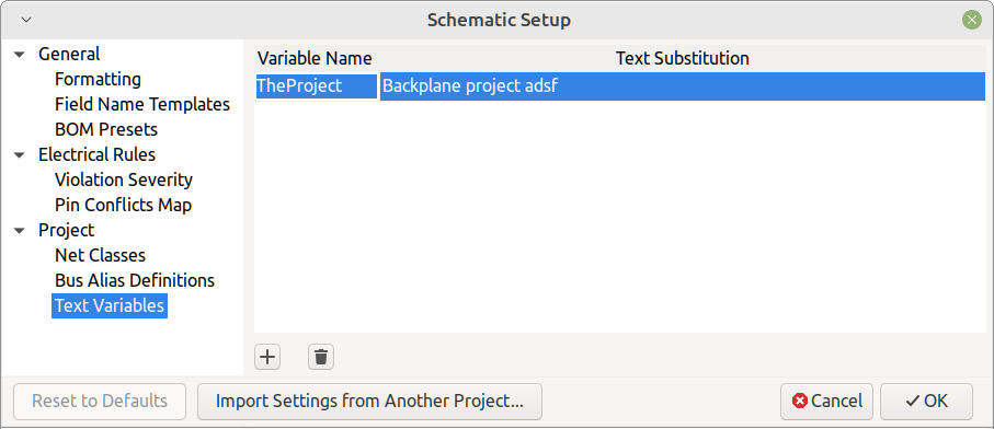

First you create a text variable in: Schematic Editor / File / Schematic Setup / Project / Text Variables

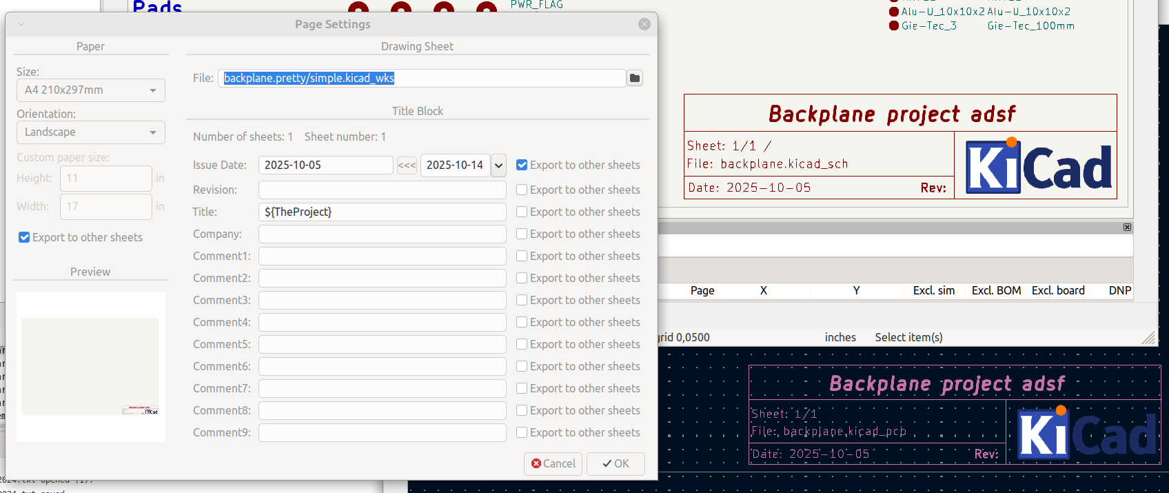

And then you use **${TheProject} in the page settings of both the schematic and the PCB.
Do note I’ve made my own (simplified and smaller) title blocks. When I change that custom variable, it shows up immediately in the title blocks of both the schematic and the PCB editors.
And now it gets a bit weird:
You can set the text variables from within the schematic editor (screenshot above) or via: PCB Editor / File / Board Setup / Text & Graphics / Text Variables. But you can not set these text variables (which are global for the whole project) from the project manager.

I do not very much like the way data for the title block is entered. With my custom title block, I also have to include a custom sheet with it’s layout to the project (I have “hidden” it in the “backplane.pretty” library (I also put project specific symbol libraries in that directory, so all project libraries are thrown together).
And now, using the text variables to synchronize the titleblocks is yet another hoop to jump through. I’m thinking of going fully custom, and just create a schematic symbol and a PCB footprint for the title blocks, and then work completely with these text variables.
Files can be embedded in KiCad V9, but I’m still on V8. The only remaining complication is that the sheet can not be empty. There has to be at least a sheet file with a line or a dot or something on it, or else KiCad defaults to the default sheet layout.
