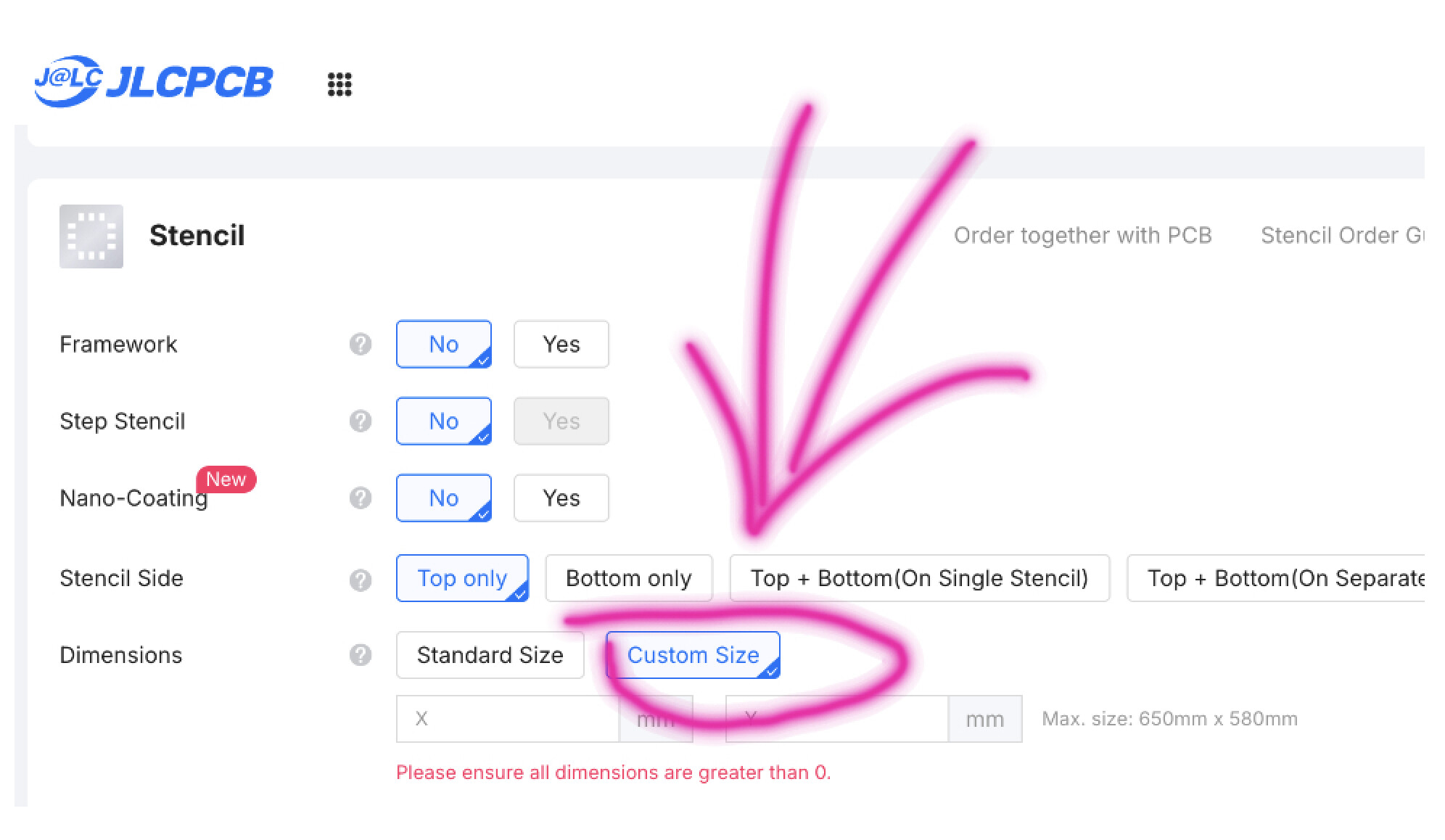

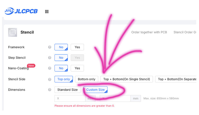

JLC offers the option to trim your stencil to any size. This will also save you shipping cost.
In a pinch, you can also cut it yourself with scissors (once) or shears.

That is what I am trying to do (drill alignment holes). As I said, the pcb program puts registration marks in 2 or more corners. I need a small (pin/needle size_ hole in the center of that registration target so I can use a sewing pin to get the stencil registered correctly on the board. I did wish I could just tell JLCPCB or PCBWay to cut the stencil to the board size. That would make registration easy!

You can communicate with them. Years ago we did this, as far as I remember it required explicit back and forth communication and drawing the outline in the paste layer. It was either PCBWay or JLCPCB.

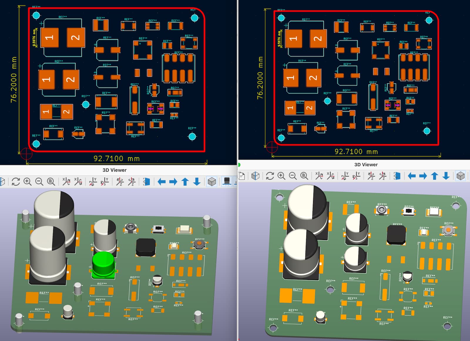

I CNC-Mill my PCB’s and use a 1mm-Pin Diameter for Location-Ref. I made a Footprint and it gets Drilled allowing me to use the Locating-Pin in my milling Jig’s. The Jig’s have Mirrored Pin/hole so I can flip the PCB and Mill the other side accurately.
I don’t need stencils but, if I needed one, a stencil would also have the Hole. Sewing-needle is just a smaller diameter Pin so, it’s easy to make a STEP model if needing a Graphic for the 3D-Viewer…
Very simple and any PCB-fab house can drill the hole (it’s no different than any other Hole or Terminal-Pin.
