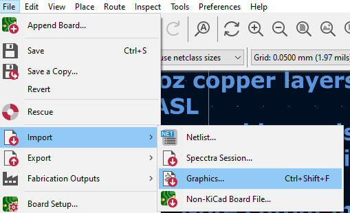

File > Import > Graphics
Select your DXF file, select your copper layer and import it . . .
You might have to do a little trial and error with the Import scale (especially if changing between Imperial and Metric) Grouping items and line widths all to suit your needs.
