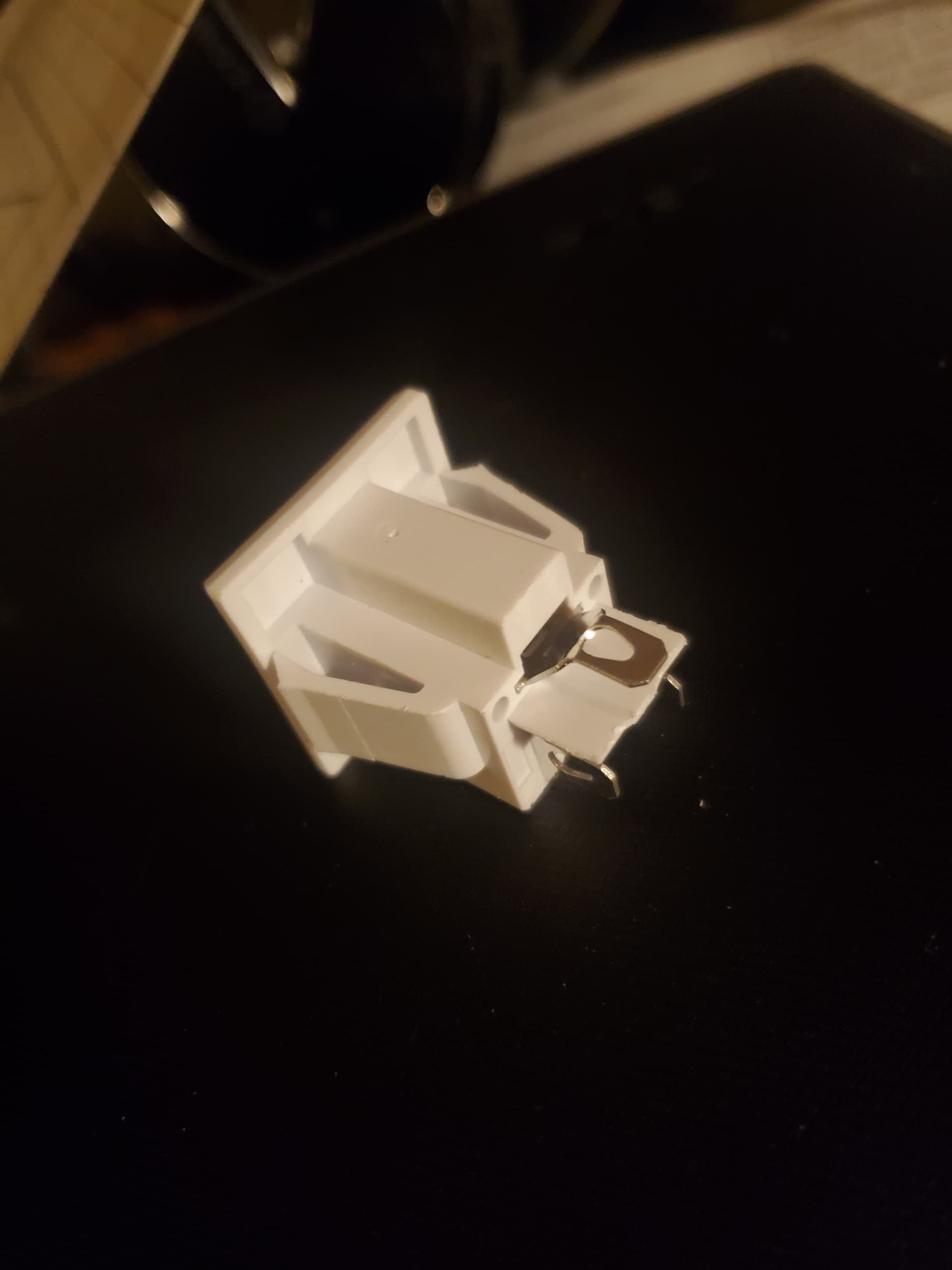

I have searched high and low for a NEMA 5-5 footprint and believe there are none. In my application I need to have slots in the board so that I can slide the terminals through the board and then solder them. I will attach a picture of the socket. I have never created a footprint from scratch and I have been looking for a plug in relay socket or something with the same type of terminals so that I can reconfigure it. This way I can get my feet wet with modifying and building footprints and not get too frustrated. The terminals are of a standard type. .2” blades. If someone has seen this footprint or could suggest a footprint that could be a starting point for modification I’d appreciate it. Thank you ahead of time.
Sockets like these are not made to be put on an PCB, so I’m not surprised you can’t find a footprint.

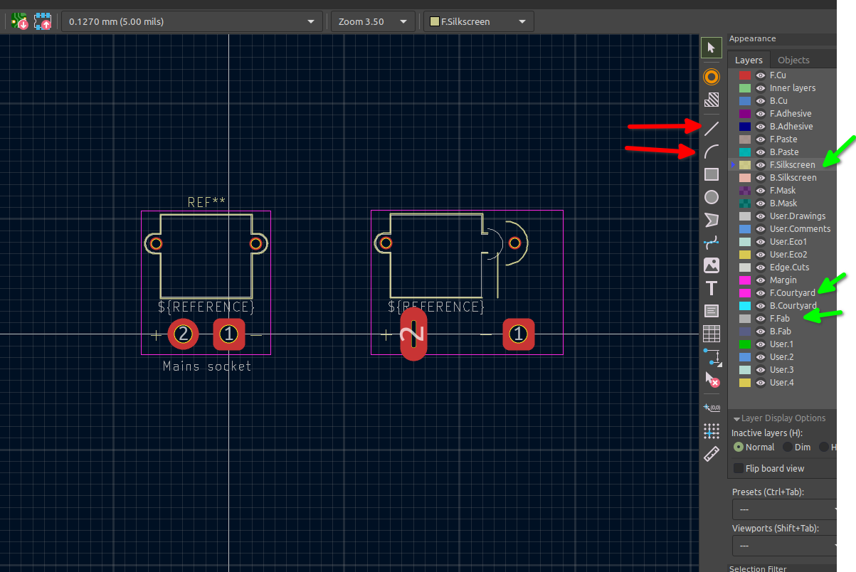

If you must have a mains socket attached to a PCB, try this method for a suitable footprint:
Find a suitable footprint from a Kicad library. I have used, for this demonstration, “Connector _AMASS > Amass_XT30PW-M_1x02_P2.50mm_H Connector XT30 Horizontal PCB Male” The dimensions will be all wrong for you, but the purpose is to show how easy it is to modify to get a suitable footprint that will pass the KLC rules.
Open the Footprint Editor, surf the Kicad libraries to find the suitable footprint, highlight that footprint then: “File > Save as” that footprint.
A window will open. Give the footprint a name and scroll through AND HIGHLIGHT the PERSONAL library in which you want the footprint placed.
(I called mine “Mains socket” and placed it in my “Test library”)
Kicad automatically moves to your saved footprint in your Personal library all ready to modify. See below.
For the purpose of this demonstration, I have duplicated my footprint using Right Mouse click (to Select) > Duplicate. I have modified the RH image.
Be aware, you may need to alter your Grids to move and/or place items. Do this in "Preferences > Footprint Editor > Grids. Note the Grid overrides that can be changed with the small arrow/triangle on the RH side of each selection.
To make your correct pads, RM click on the appropriate pad and select preferences.
See pad No. 2 as example.
Change the pad shape and size and the hole shape and size.
If you need more pads, add them using the top toolbar “Place” then edit those also.
Move the pads into the correct position and spacing required.
If you need mounting holes, modify (RM click > preferences) the two existing holes and move them to their required positions.
Move/Drag or delete and create new Graphic lines with the Icons (red arrows) on the three layers (green arrows) to match the dimensions of the footprint required.
