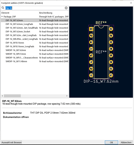

I realize for the first time a very standard component cannot be found: The SR latch 74HC279
I seen it had been requested some years ago. Any idea where to find it?

I had a quick look around and also can’t find it anywhere. The fastest way will just be to clone another component and create a new symbol for the 279.
It’s just a rectangle with some pins on it. Have a go at creating it. You’ll learn stuff for the next more complicated device.

The footprint is the easy part. Choose just about any DIP16 package and take away what you don’t want. :wink:
I would take it and change it in the symbol editor and save it.
I would make a 5 unit symbol (4 latch and 1 power unit) since the units are more likely to be used individually than bussed.
