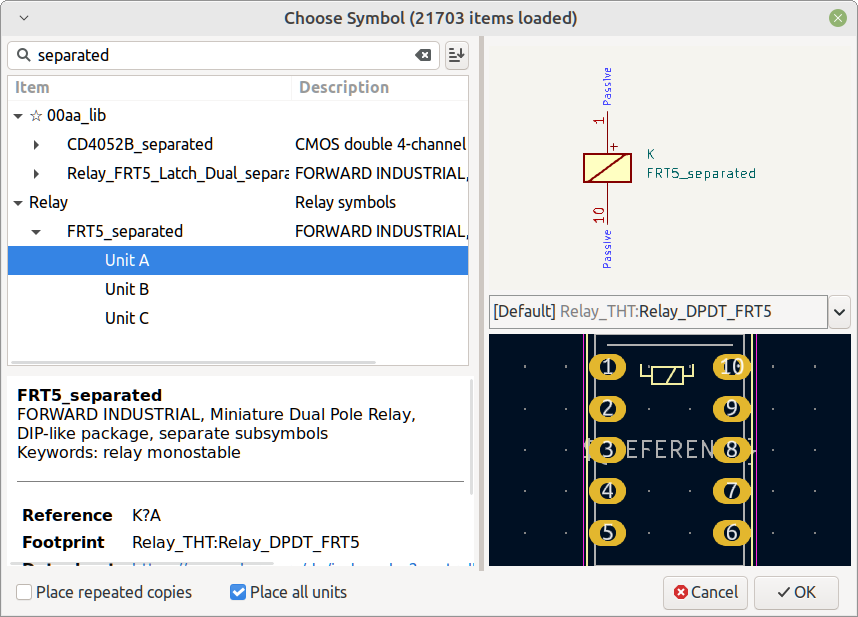

There are a few relays with separated coil and contacts. FRT5_separated is one of them.
G5V-2_Split is another one.

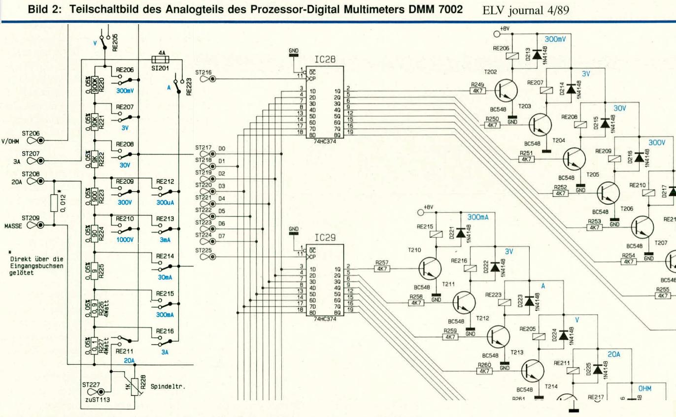

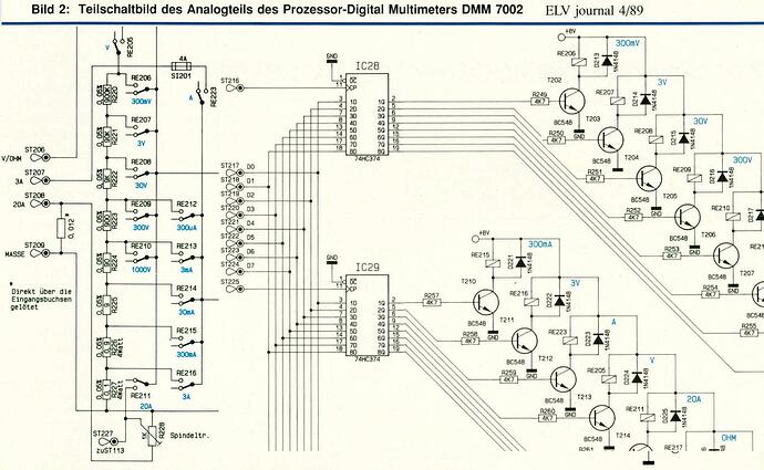

As a sidenote… Yesterday I was looking at the DMM7002. It’s a benchtop DMM published in the ELV Journal 1989-04 and -05. (This magazine is freely downloadable from the official website). This multimeter has very nicely drawn schematics, divided over 8 different pages. It also has around 25 relays. Below I made a composite screenshot of a part of the input section, and of the relays drivers.
Without splitting the switches from the relay coils, this schematic would have been a real mess. Splitting relay contacts from their coils is pretty much industry standard. It is very often the cleanest way to draw the schematic,

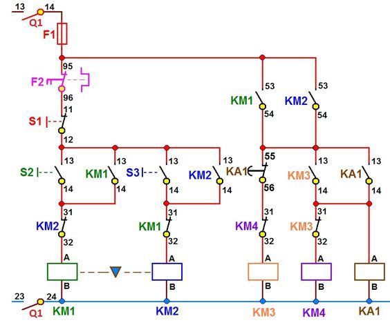

Just for emphasis, below another example of “relay logic”.
Relays_Schematic
