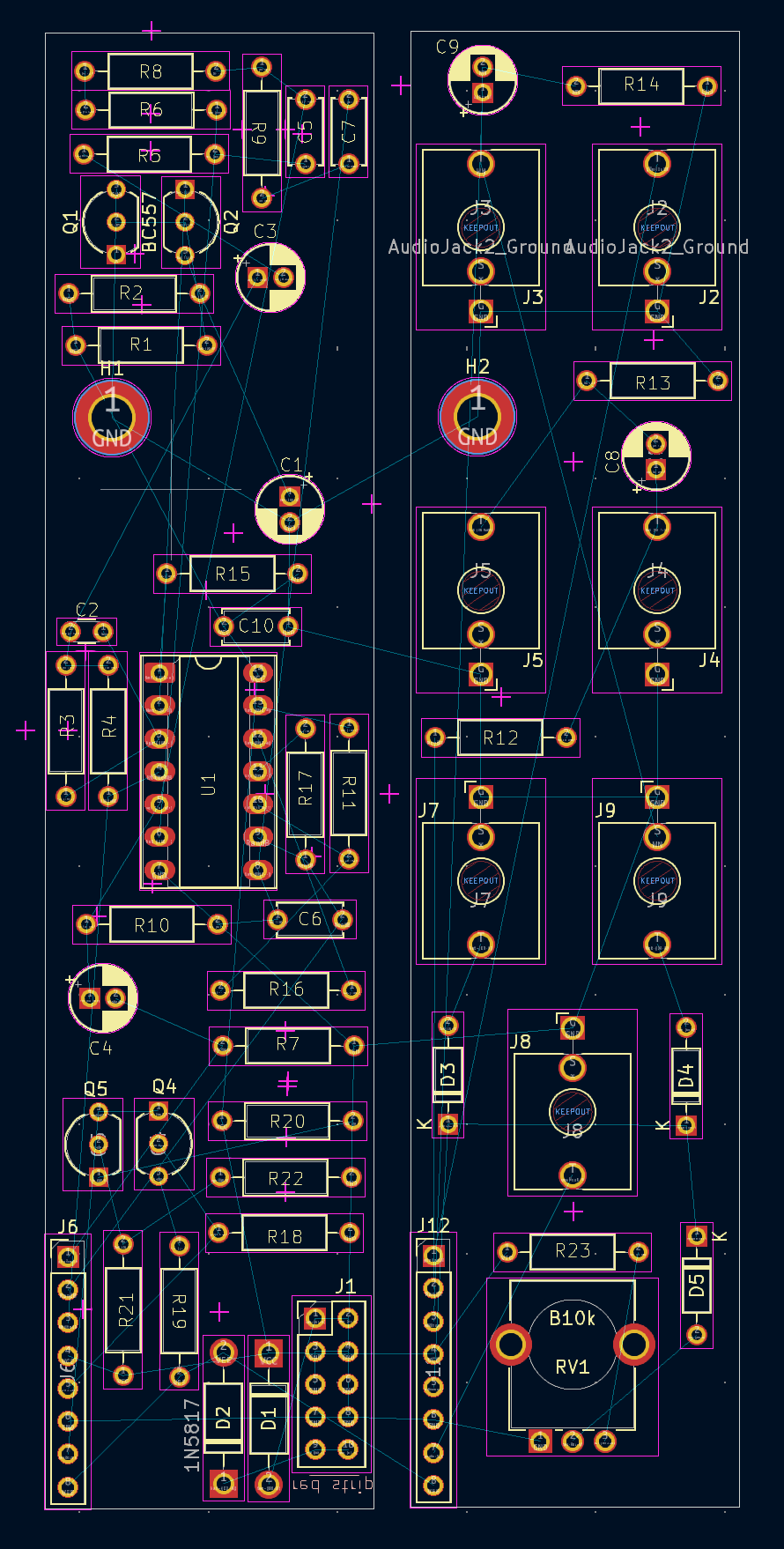

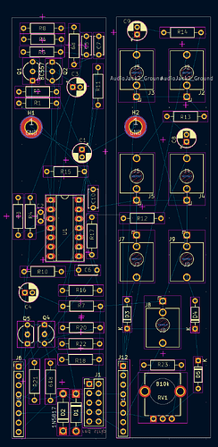

Split into 3 seperate board from the same design

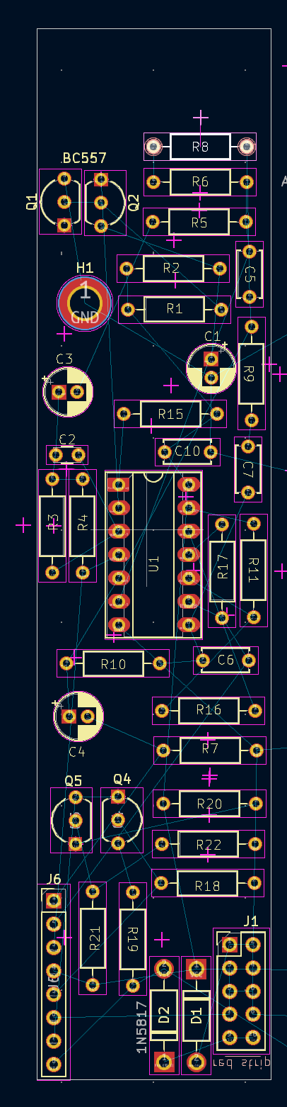

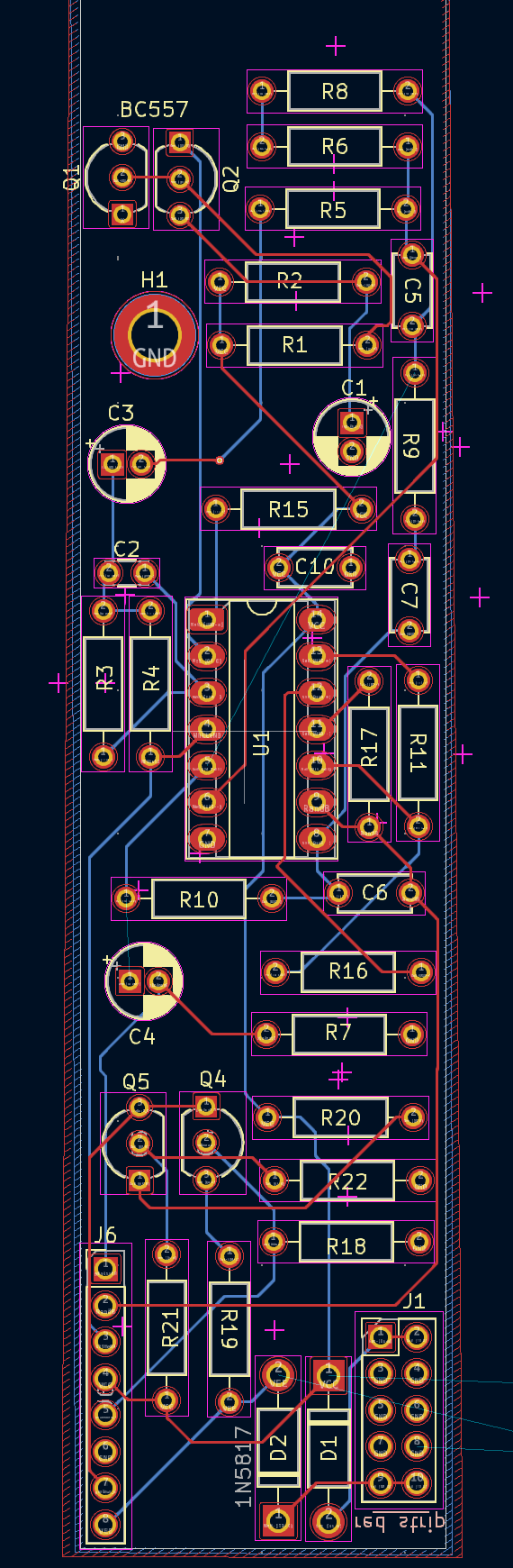

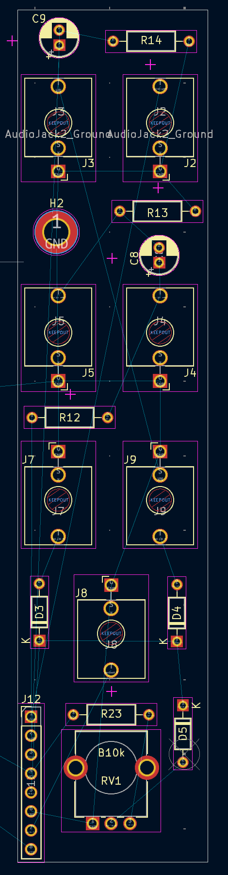

First, your PCB’s look atrocious. PCB design is more then drawing some tracks and filling some zones. At the moment you don’t have a decent GND plane on any of your PCB’s, and it would not require much work to put the tracks on one layer and using the other layer as a GND plane.

I know. This is the thing I always stuck at! I just don’t know how to route a PCB… It looks too complicated… :frowning:
Thanks this worked great!
Yes, that’s pretty clear from your track layout. It’s a typical example of a beginner letting an autorouter do the work without even trying to put some manual effort into the design.
Yes, looking at the layout there’s not much that could be worse.

Mabe final note: Doing proper PCB layout is 90% about placing the components. Actual routing is simple in many cases.
Typical result of just letting an autorouter ruin your board. Also see OP’s other thread:

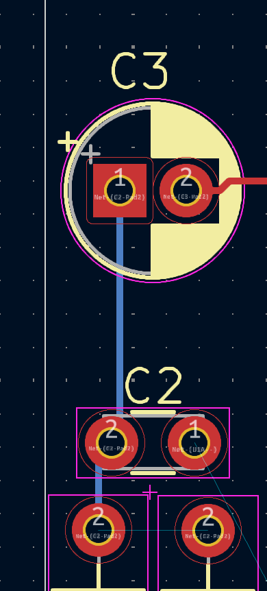

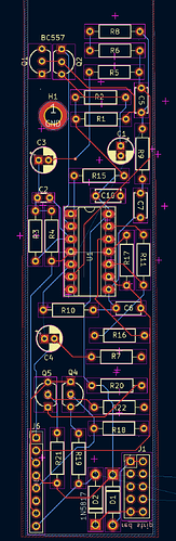

He’d have to do more then that. At the very least he’d have to show that he put in some effort from his side. An then still the answer is the same as the other layout reviews here. Footprint placement is indeed the main thing (Just look at R11 relative to U1 for example), and the second thing is the GND plane (Which I have already mentioned). When those two things get fixed, the design is probably already plenty much good.

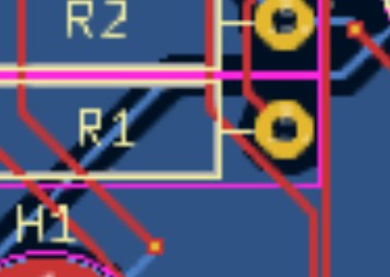

Except for the third thing that really needs fixing, and that is the extremely small via size. I don’t know what the via size is, but it’s extremely small and likely below the minimum (cheap) drill size. See the magnified section of the posted screenshot below.
Thin deep holes can be drilled, but they do cost extra because the drills are very fragile which slows down production.

For example let’s adress those microscopic tracks and vias. Just guessing, we might suggest 0.4 mm tracks and 0.6/1 mm vias. This leads to board setup, setting rules for the default class and so on. Maybe adding a power class with 1 mm tracks just for practise. Those are already a number of nontrivial KiCad specific tasks (where, when asked in the eevblog/beginner forum I might think: Why does this guy not ask in the KiCad forum?)

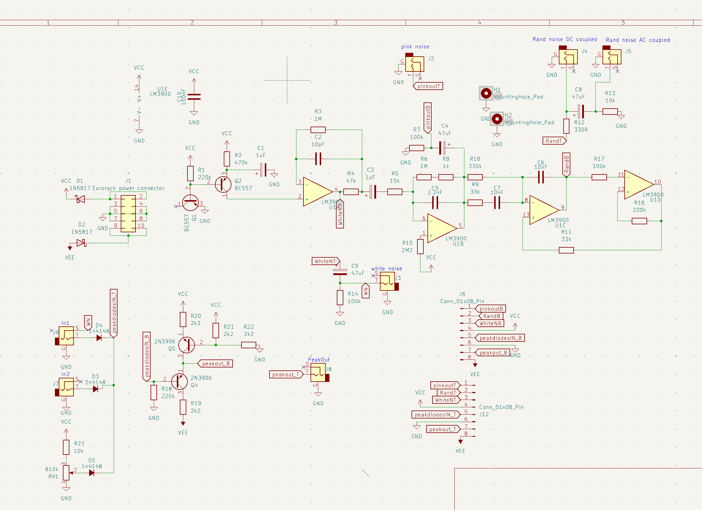

I understand there’s some debate about whether this forum is meant for PCB design questions — but I’ll go ahead and share my schematic and basic PCB layout here in case anyone’s open to giving feedback. If not, no harm done.
schematics:
I’m using global labels (net ports?) so I can divide the schematic between two PCBs:
  • The bottom board holds only components.
  • The top board includes mostly front-panel elements — jacks and pots — along with a few regular components (resistors, capacitors) that fit closely around them.

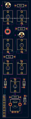

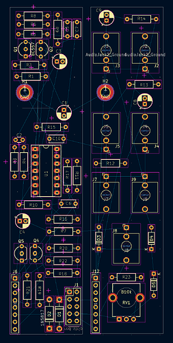

here is the two pcbs with the way I placed the components:
bottom board:
top board:
bottom and top board close to each other (for better seeing the whole design):
You’ll really have to show you’ve put in some effort from integrating the tips already given before I would be inclined to give any further advise.
At the moment I’m more inclined to closing the thread as “off topic” then to making any other contribution.

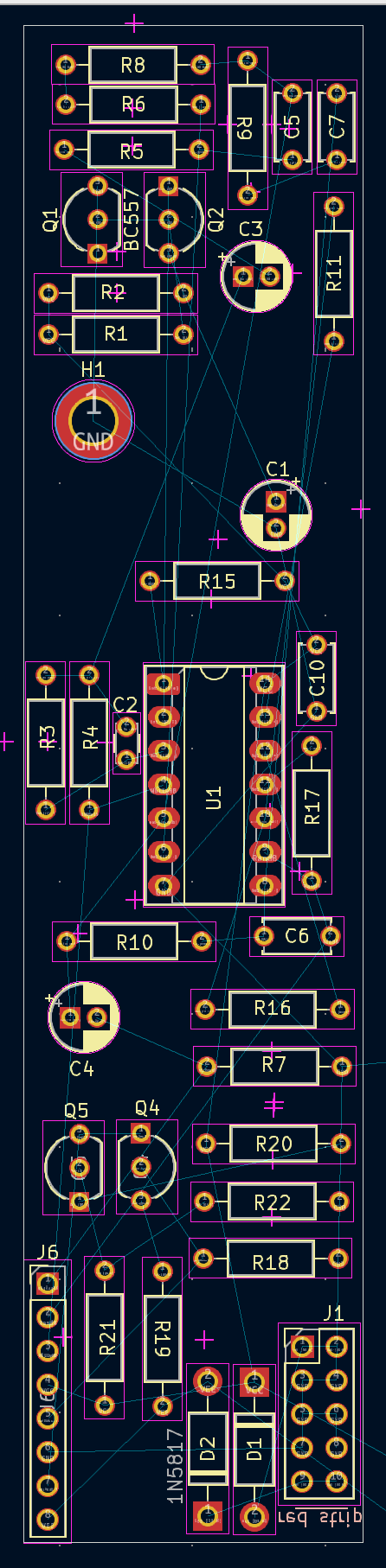

R11 fixed now:
What I should make with the ground plane?
more changes made regarding bottom board:
edit: regarding ground connection - if I get it right - No need to route tracks between ground pads because I should make ground pouring on both side of pcbs? this will ‘save’ me plenty of routing(?)
so I start again to route my pcb, I feel it is going much better. I use bottom track (blue) for vertical routing and top tack for horizontal routing.
in this scenario:
R3 lug 2 should be connected to R4 lug 2. they are much close apart. should I continue this connection ob the bottom part (blue line) or switch to the red line (top part) ? what would be a better choice in that case?

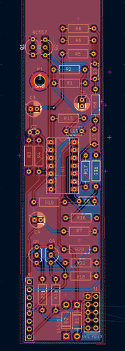

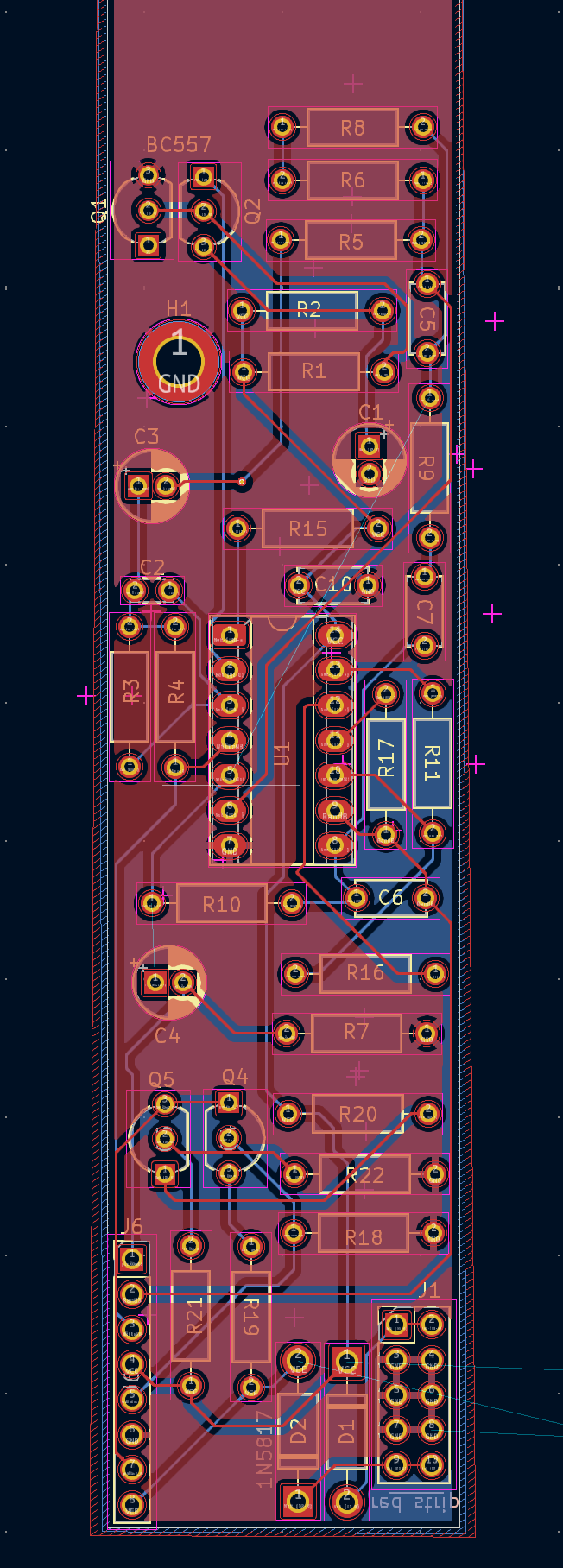

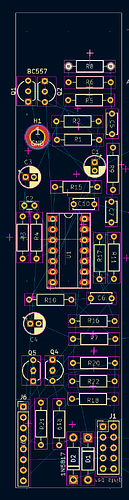

Here is my try to better routing the bottom board:
here is it with hiding the copper zone area for better seeing my routing:
Nope. Still garbage.
Throw away the auto router, do the routing manually on one layer and keep the other layer intact for the GND plane.
Also, the amount of screen posts you make does not help your cause. Sit back for a while, do some real studying and then create and post a proper PCB layout. I guess that for your first PCB this will take one or two days of work. After you’ve done a handful, you can do a PCB of this complexity in an hour or two. (Including footprint placement, which takes more time then the routing on itself).
