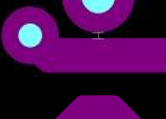

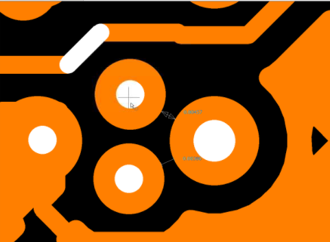

PCB manufacturer had those rules:
  • 0.005” minimum trace/pad spacing
  • 0.006” minimum spacing from copper traces/pads to copper pour (copper plane)
And I got some problems with that, when via/via and via/track spacing is smaller coz of same net. But manufacturer dont care about nets.
11qaq
1qaq
For Kicad its not and error coz of same net, but for manufacturer it is.
