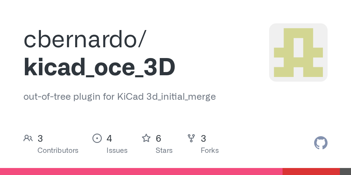

The development (aka ‘product’) branch of KiCad supports visualization of mechanical models (STEP and IGES) via an external plugin:

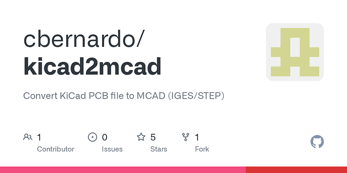

The kicad_pcb file can be translated into a STEP model for mechanical designers via the ‘kicad2step’ tool:
Unfortunately you have to build those tools on your own at the moment; we’re still working on build/install issues on OSX and Windows.
