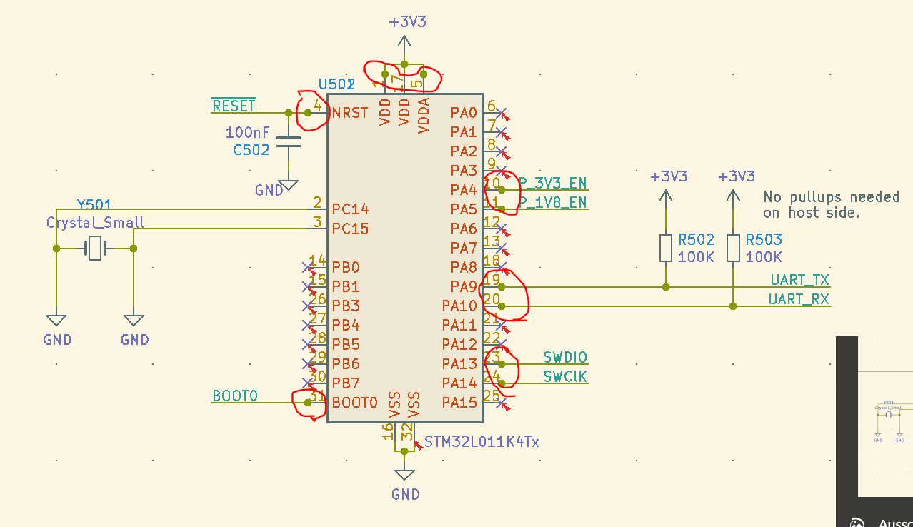

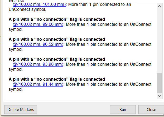

I’m extending a schematic started with version v5.1.5 with the new v5.1.6, I added an extra hierarchical sheet, cleaned the old component names, renamed the whole schematic and ran ERC, now I have some unwanted junction dot in my new sheet (I deleted some already before noticing that something as going on):
I took a look at the other sheets in the schematic (the was that were already there) and all looked normal, however I am not sure when this unwanted junctions appered in the design (I suspect the reannotation or the ERC, however, I haven’t been able to reproduce it again).

p.s. also those red arrow seem out of place because those pins are not connected.
Somehow I had two symbols on top of each other. All is good now.
Some other notes:
Pullup resistors for a UART are “unusual”, especially for the output.
Does this uC not have internal pullups?
You’ve shorted your crystal to GND, some caps are missing there.
