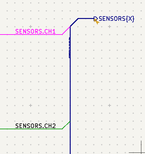

This is the source of the bus on the first sheet (the tiny label on the bus is the full definition SENSORS{CH0 CH1 CH2 CH3 CH4}). The erc error says “Both SENSORS{CH0 CH1 CH2 CH3 CH4} and SENSORS{X} are attached to same items; SENSORS{CH0 CH1 CH2 CH3 CH4} will be used in the netlist.” I can live with that as a warning for the sake of a simpler schematic:

You can define X to be a list of signals in the bus aliases dialog. If they then match the signals on the actual bus, the ERC issues all go away. It lets you define your buses once and use them all over without having to put in the signal list all the time. For example, I have an HDMI bus definition with all the high-speed diffpairs and low-speed signals, and I can route a busname{HDMI} between things and ERC is happy. Then I can right-click the bus and unfold any signal I want from it, so I never have to type in the individual signal names anymore. It’s great. In your case, just put the full signal name list into a definition for your abbreviation and ERC will be happy and actually check if you did the right thing.
Ahh, the alias is not for the bus name, it’s for the members. That makes sense and worked for me. I defined alias CH to be CH0 CH1 etc, and then used hier pin name SENSOR{CH}, which is nice and short (and better than {X}) and then I can remove the bus label that was annoying (which I previously made tiny) – much clearer and cleaner and the erc error about conflicting labels is gone. There are still erc errs on bus nets (label not connected to anything) but that is a different issue and I thought I read that it was a reported bug.

I also see squares on your bus exit points. I guess you just drew wires there instead of using “real” bus entries.
Yeah I did use wires as it seemed faster and seemed identical, but I guess it is not the same. Didn’t notice the boxes. I will tidy that up as well.

Before KiCad V6 the bus was visual only and KiCad relied solely on the wire labels to recognize connections.
Those boxes indicate open wire ends, and to me they are always an indication of possible faults, and a while you will probably also recognize them for that. But in themselves they are no direct faults.
A possible problem with using wires for this, if that if you have connections on both the right and left side of a bus, then the wires will connect them together, while the bus entry symbols will not.
