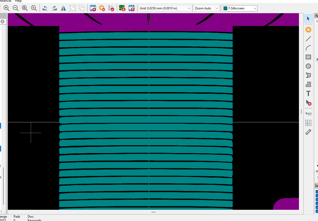

I got a LOGO to adjust and I’m making the version for the layer F and the layer B.
I started and finished the F, now Im transfering on B.
But I can’t bulk select shapes and move them all at once. I have to do one by one:
Tedious operation.
Is there any shortcut?

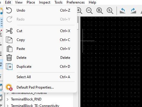

Have you seen Edit->Edit text and graphic properties ?
I don’t see it into the Footprint Editor
Because it is not there. You did not mention you are in the footprint editor.
I thought it was clear, since it’s the only one place where I can edit the footprints. However, I added now into the title, so I hope there will be not any further misunderstanding

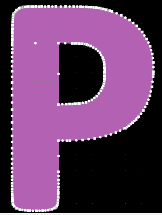

BTW, I have to mirror this because i have transferred to B layer … no functionality either for this …
Im’ sooooooo happy …
• How about exploring the standard tools when you Right-Click (…mirror…etc)
• Try Window-Boxing all the Lines, Copy (select a ref point), Paste into desired layer. Delete the one’s from the other layer if not needed…
Damn you’re right. You will never believe.
I did it several times. I didn’t find “mirror”. It was under my eyes :-/ My apologize
Found the bulk way!
It’s not EDIT it’s called “Change Side / Flip”
Which one guesses ti just change the side to work. Instead transfers the select objects on the other side
