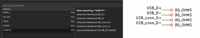

For instance, here.
I want to select those 4 signals on the right (excluding the unconnected)
This would be quite trivial with regexp.
I believe that right now only the Wildcard * is working.
I can only hope this would be more clear after reading the thread I linked, but I don’t think it will be. As was said there, the pattern is tried as both (regexp and wildcard), and if either style matches, it’s a match.

Alright, I could achieve the desired thing with this, but this is not reliable because if the signal ends with D1 or anything that is not + or - it will match.
I think you can do pretty much anything with regexp. Wildcard matching is very simple. Regexp requires actually learning the syntax.
I could not make any regexp yet.
Do you know how do you make a pattern that matches anything that ends with + or -?
Netclasses - Wildcards - #4 by itsko tells that the syntax is here: wxWidgets: Regular Expressions. I’m not a regexp expert, maybe someone else can help. It really wouldn’t hurt to have examples in KiCad documentation for common cases… the naming style used in net names is usually limited and similar patterns would be often found.

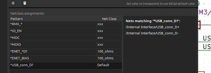

Here is another example.
I have 2 regexps
  • *ENET_*D? which finds the wires (in the Schematic Setup)… but does not mark the wires in the schematic (they should be Red)
  • *ENET_BIAS? this one finds the wire ENET_BIAS and makes it Red.
All the ENET_*D? and the ENET_BIAS should be red because they were being added by the Wildcard/Regexp
Now, this time, when I add the net class with the toolbar button, then it adds.
oh, this does not work for me.
this neither
this works with the
this also works with ? since it is a single character
You are using a single-sheet project, I think. i am using multi-sheet. Do you think it may be related? I ma going to check.
You are also using global labels…
I checked the bottom of the page, and the wires I want to filter have the right name.

Wait, what?
. for local labels. this is confusing. since .` is a regexp command.
Yes… I’m giving you a regular expression to solve your problem. You can’t do the thing you want with wildcards (select the ones ending in +/- but exclude the ones ending in something else).
Nothing is wrong: putting in USB* won’t match any local labels because all local labels start with a sheet path (/ on root sheet, etc)
Sure, I don’t want to use wildcards. I want to use regexp. But the regexp was not working.
Now, with the dot in front, it looks like it worked. I am going to neeto to test it more.
But the dot in regexp means this:
Alright, that makes sense, thanks. But I still have one extra issue… let me get another example.
Here I am on another sheet that is not the Root.
Ok, got it.
This dot in front does all the magic.
If I use * directly I am using wildcard instead of regexp, and this is messing up with my pattern.
thanks @craftyjon all good now!
