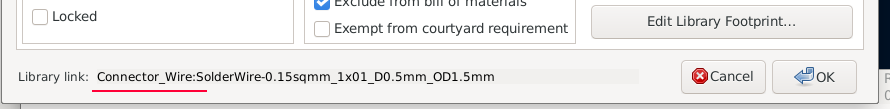

However, this leaves the DRC partially unhappy:
If I compare the footprint properties with the same footprint manually added, the “link” misses the reference to the library name, and just contains the footprint name
BAD
GOOD
how can I fix this?
thx
Use SetFPIDAsString() method on the footprint
awesome thx. that was “qu1ck” and worked like a charm with
m.SetFPIDAsString( <lib_name> + ":" + <lib_footprint>)
