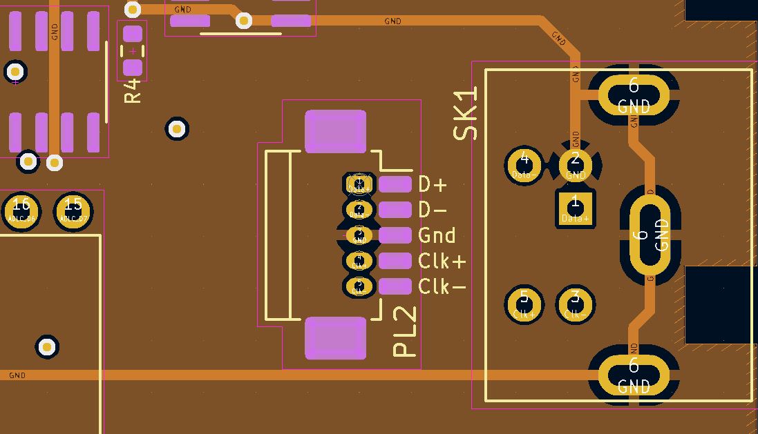

I’ve created a new footprint (PL2) by merging a SMT and THT footprint together. I’m using this on a 4 layer board, where the outer layers and one inner layer have a Ground pour across the entire layer. The other inner layer has a +5v copper pour across its entire layer. The issue I have is that when one of the PL2 THT pads is connected to GND, the entire outer layers get flooded with copper, obliterating any other tracks on that layer. If I attach a different net to the THT pad, the flood works correctly with the correct spacing between the various tracks and the Ground pour.
PL2 THT Pad 3 attached to GND. No copper pour shown:
PL2 THT Pad 3 attached to GND. Ground pour shown, obliterating all other track:
PL2 THT Pad 3 attached to a different net. Ground pour shown, all as expected:
What am I doing wrong???

I’ve just updated to v7.0.7 and it seems to have solved it:
PL2 THT Pad 3 attached to GND. Ground pour shown, all other tracks now correctly shown:

This was reported as a bug on 2023-07-10 and fixed two days later:
Actually, I think there may still be a residual bug here? The Thermal Relief gap setting still seems to be getting ignored.
The final picture in my first post shows several GND pads on the RHS with the appropriate gap. These gaps don’t exist in the picture on my second post, which was done on v7.0.7.
Have a good look at the commit log for 7.0 since the 7.0.7 tagging. There have been a few thermal relief fixes. The Testing builds include these
Excellent. The latest Testing build has fixed it for me. I now have the correct thermal relief and spokes on my GND pads:
