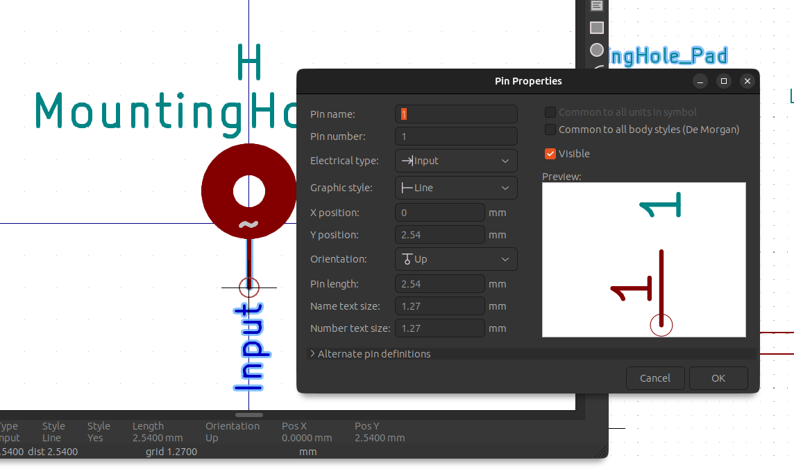

[SOLVED] ERC: Pins Input and Unspecified are connected together
The mountpad is Input.
The GND is Power Input.
I can also use a PWR Flag, but it does not change anything.

What are the properties of the GND pin inside the GND power symbol? It should be Power Input electrical type. If you edited the GND pin it might not be so.
gnd-pin-props
Good question. I forgot to mention it. It is Power Input as you are showing. I didn’t change the power pin, but I do have some that came form colleges. Is it possible that having one bad apple I end having the issue spread everywhere? Also, if this is happening, you do I check that? Maybe it will be easier to check looking inside the file with a file editor then.
I wouldn’t get a power symbol from outside the standard KiCad library, there are subtleties in how they are constructed.
One thing you could try is to reload the power symbol from the standard library to see if that changes anything.
I checked here, and all the power symbols are from the Kicad Library. This is not the issue, then.
My ground symbols are all the same.
So you then need to check the electrical type of the other pins on that net. There are 4 mounting holes, what type are their pins? And remembering that sometimes the ERC points at a location far away from the actual culprit, I would check all the other pins that are connected to GND.

I found that the USB_B_Micro has GND pin 5 as Power Output too. This is complicated.
You can click on the error and you have several choices. But I think you have an Unspecified pin lurking somewhere else in your schematic that’s connected to GND. Do you have any symbols imported from a foreign library? Often their pin types are not correct for KiCad.

Nice, I could find some unspecified pins. Let me see if I can fix this.
Good job, I found one symbol (spread everywhere) that is connected to GND and has this unspecified pin. Let me check if I can fix this issue.
@retiredfeline thank you. Your help definitely solved my issue. There were some unspecified pins, connected to the ground.
