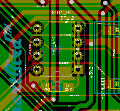

[SOLVED] DRC finds unconnected pads but they look connected to me

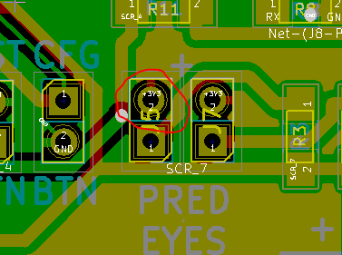

I don’t get it. There is a large +3.3V zone that I connected 1.) via a track from another component 2.) via direct connection on the Pi header. Yet it still says it’s unconnected on the two pins in the first picture. And there is a GND pin (Pin 7 in the last picture) that is clearly connected, as far as I can see.
What am I doing wrong? See DRC report.rpt in the project folder. I have also zipped up the project folder.
J7 Pad 2 is clearly not connected, it’s on a little island!
The DRC finds the closest point between unconnected pads, but usually only one of them is the “unconnected” item.
Ahh thank you. In each of these three, the unconnected item is the second one listed on each report line item. The crosshairs would point to the first (well-connected) pad and lead me to think that was the problem.
You learn something new every day.
