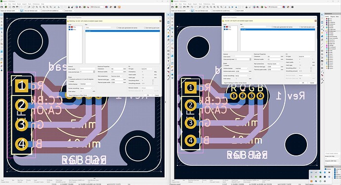

I installed V7 today and opened a small V6 project. All looks good, apart from the copper pours around the mounting holes.
These zones are isolated and meant to save some etching. In V6 the zone uses the clearance around the mounting holes, while V7 pours right up to the mounting hole. Looking at V6 and V7 side-by-side I do not see any difference in the properties, which makes me wonder, did something change there or is a setting somewhere else controlling this?

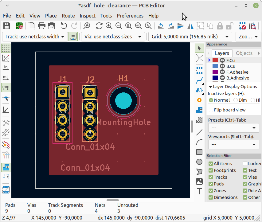

It looks like KiCad 7 ignores “Abstandsmass” (not sure about the english term) in the copper pour settings for holes that are manually drawn (instead of NPTH) with Edge.Cuts.
In KiCad you can set it by settings the Copper to edge clearance of the board. If you want that clearance for only the copper pour and not for tracks, you may have to use custom rules.

Edit: It was already implemented in version 6.

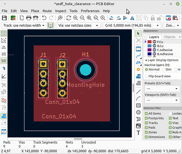

As you can see, there are different clearances for the PCB edge and around the hole.

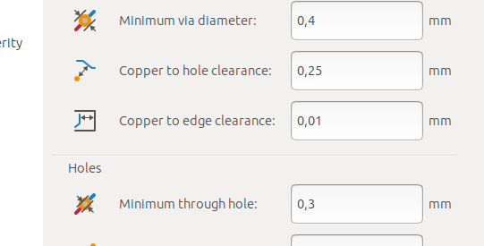

You can set these clearances in: PCB Editor / File / Board Setup / Design Rules / Constraints as the Copper to hole clearance (I set it from default 0.25mm to 1mm) and the Copper to edge clearance (Which is Zero by default, and I set this to 2.5mm).
In my test project KiCad sets these two clearances independent of each other.
Thanks, I learned something today. The default copper to edge clearance was set to 0 in both instances, but in V7 it used it apparently. Setting it to .8mm gave me the same result as I had in V6.
