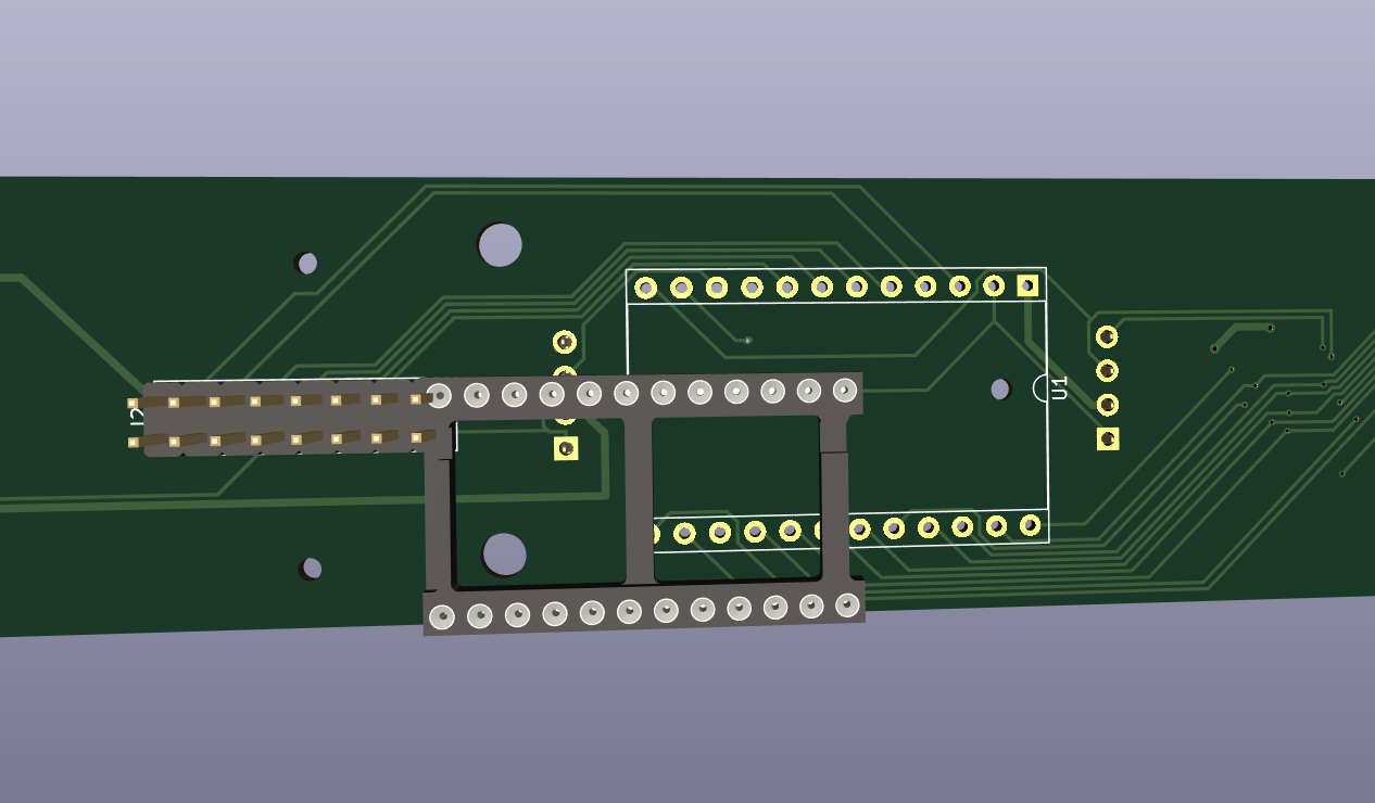

So when I look at my board in the 3D view, I see this:
If it’s not immediately obvious, that issue is that the socket should be aligned with the U1 pads. I’m at a loss for how to make this happen. I tried resetting the anchor point for the (custom) U1 footprint to be at the origin.
It occurs to me that pin 1 of the part appears to be at the anchor point of the footprint. Should I be setting the anchor point of the foot print at the center of Pin 1 of the foot print? Is there a way I could’ve known this without the 3D view? Or is there a way to change the “anchor point” of the part without changing the anchor point of the footprint? (because that was a bunch of effort to reconnect all the tracks.)

Works for me with DIP-24 15.24 mm from KiCad’s standard footprint and 3D model libraries. Did you get yours from the standard libraries?
No… I need a 17.78mm (i.e. 7 holes wide on a standard board) wide 24 pos (2x12) socket, so I modified a copy of the 15.24mm one in the footprint editor.

Oh and… for future people who may see this, yes, if I move the anchor point to the center of pin one, that solves 15% of the problem, and explains why the part in the 3D model was so far off.

Ok, if you’re going to make your own THT footprint, the origin should be on pad 1.
To align a 3D model with the footprint, you need to use the KiCad StepUp addon to FreeCAD. This is described in detail elsewhere.
In the Footprint Editor, select the part, and then File/Footprint-Properties, then click on 3D-Model tab. Look at lower left for offsets you can tweak. Rotate the 3d model so you can see the pins on the bottom to fine-tune.
