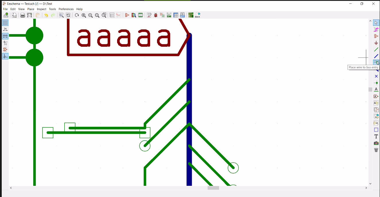

Is there a way to place smaller bus entries? I find that the normal size interferes with placing other stuff nearby:
Manually adding a 45 degree wire where I want the bus entry to be, does not work as it does not connect to the bus:

In 5.99 and 6.0, diagonal lines are not the same thing as bus entries! If you just draw diagonal lines, some things like ERC will not work correctly.
There is no way to change the entry size right now; please file a feature request for it

eeschema in v5.99 already supports smaller bus entries but there just isn’t a way to create the object yet from within the GUI (that would be the feature request).
There is a workaround right now which relies on the ability to paste s-expression text elements as schematic objects.
The below will generate a bus entry with a size of 1.27mm x 1.27mm (i.e. 50mil x 50mil). Just copy the below text and in eeschema (v5.99), do a “Paste” and you’ll be able to choose where to paste it.
(bus_entry (size 1.27 1.27) )

A better workaround would be to reduce the grid size to place the wires closer together.
Select the “wire to bus entry” option
Right-click and select the grid size as 10 mils
As you can see the wires can now be placed closer to each other.
If connections are an issue then select the “Place junction” option and use junctions to ensure a connection
Generate the netlist to see if all the required connections are done.
