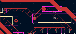

is it possible to transform a closed single track route into an entire copper zone?
to be able to see/have an area that takes the connectors of the different capacitors.
Select it > right click > Create from Selection > Create Zone from Selection…

yes ok, I trace the area, but then how can I see it all in copper?

You must manually invoke the filling calculation for zones. And you must have “filled zones display” enabled.
  • Edit–>Fill all zones (or select zone and use context menu)
  • View–>Drawing mode–>Draw zone fills (or button on left icon bar)
like this?
is it normal/correct that the area has a different color than the tracks, or do I have to apply some properties?
  • your zone is calculated → good
  • your zone is not connected to the pads of the footprints → you have to assign the correct netname for this zone (for this the net must have a netname assigned already in the schematic).
  • color: look into the appearance panel on the right side

actually i see that many footprints are < no net > name and it doesn’t allow me to assign it. how do i solve it?
Draw a schematic first, annotate it, assign footprints, check ERC.
Then in PCB editor > Update PCB from schematic (F8).
It will refresh and re-assign nets and footprints.

I created the entire board directly in pcb editor to avoid trace problems in the connections.

if you find yourself in the situation to fix it you have to update all the footprints, repair any trace errors and you can solve.
