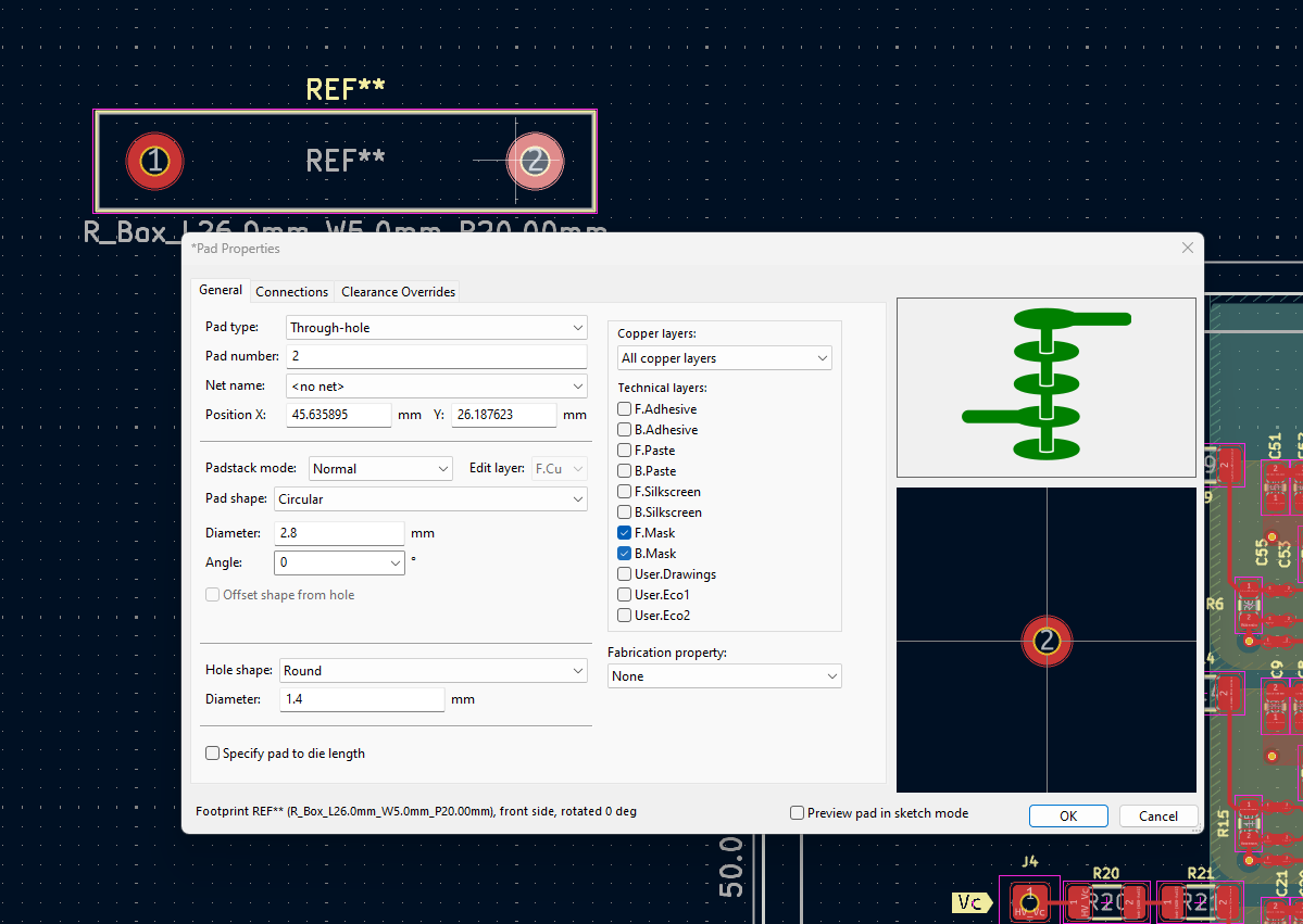

I just made my first PCB, and I only routed the bottom side (I didn’t need the top side), but Kicad doesn’t offer single-sided routing, and the footprints are all multi-layer with plated-through holes.
To have the single-sided PCB manufactured, I think I only need to send the “xxxxx-B_Cu.gbr” layer, but the Gerber generation only produced a “xxxxx-PTH.drl” file (the “xxxx-NPTH.drl” file is empty).
My question is: how do I have a single-sided PCB manufactured with unplated holes?

By actively not using the 2nd layer and using NPTH. The real question is how to use NPTH instead of PTH.
The single-sided PCB’s I design and procure are all IMS so these are subtly different as these are 100% SMT and thus its a case of ignoring the B_Cu layer and only providing the F_Cu later.
If you are using through-hole components then you need to disable the 2nd B_Cu (or F_Cu, depending on your reference) pad ideally as a new footprint OR on a footprint by footprint basis.

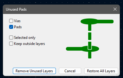

Another option is to use the “remove unused pad” option and untick “Keep outside layers” and ensure that EVERY part has a track, even a stub, otherwise this will remove EVERY pad
It also may be that your manufacturer will just take a “normal” PCB (one copper Gerber and either a combined or separated drill file) and simply not plate the “PTH” holes in their 1-layer process.
You should contact them and ask how they want the data presented for your desired effect.
Also remember that for small-volume FR4 stuff, you’ll barely save any money (if any) with single sided vs 2 sides, and a PTH barrel and far-side pad really helps with cold joints with soldering and avoiding delamination and plug pull-out during rework. Which may not be relevant for you, but if it’s a price thing rather than a technical thing, do check that it really is cheaper for you.
