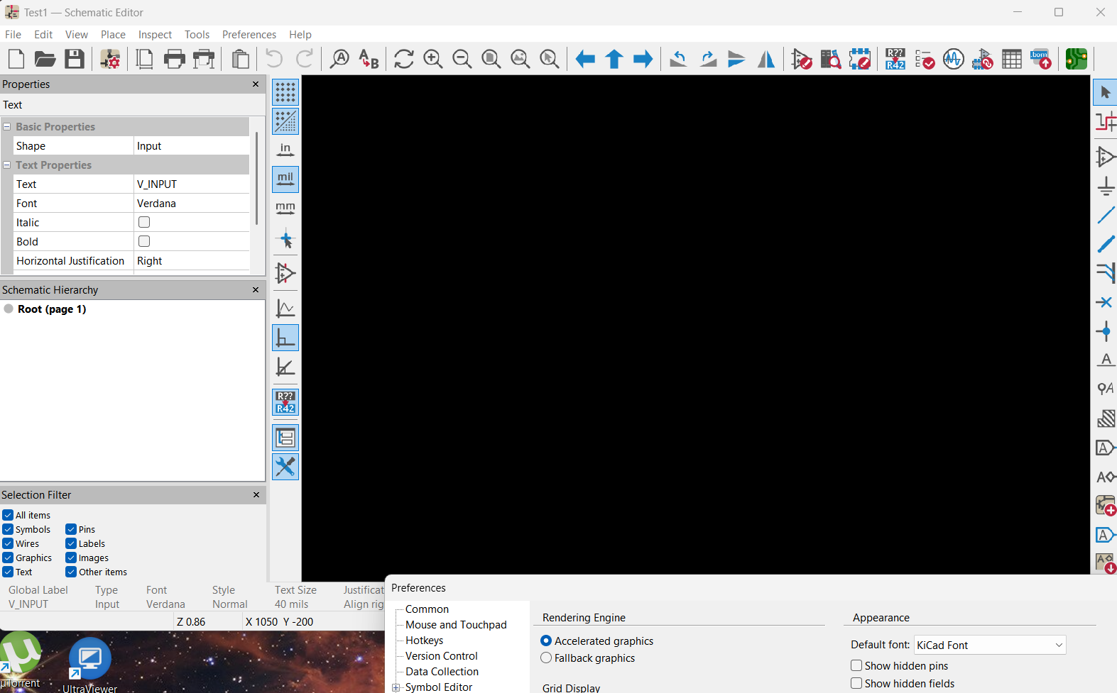

i am new to kicad ,i create project which shows black in both sch and pcb, Need Help!!

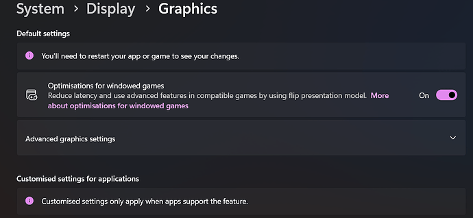

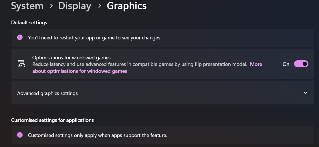

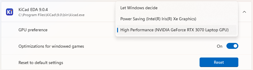

i am done in customised settings in graphics on windows settings, add kicad.exe for customised settings. restarted checked on fallback graphics its working, not work on accelerated graphics, any method for accelerated graphics to on

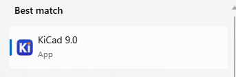

Did you start kicad from kicad.exe then? (the main app)
I Just Add kiCad in customised settings for applications windows settings graphics location, location of image attached u can see there, I start kicad in desktop shortcut.

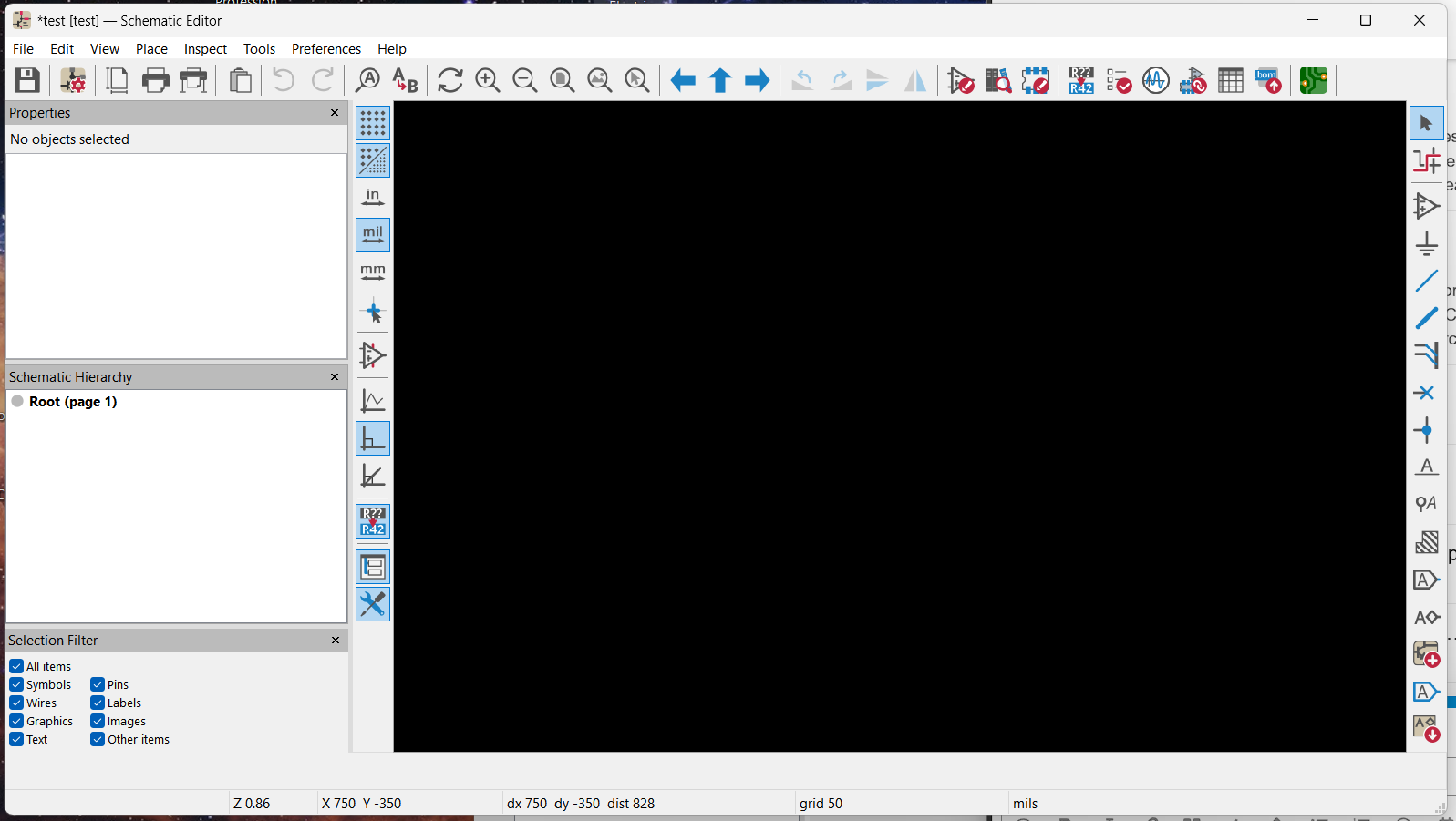

In rendering Engine, while using accelerated Graphics black screen still shows, For this u have any solution
Do you have it like this?
Do you have any schematic symbols placed?
What are your color preferences?
My background is set to black.
…with no symbols placed in the schematic you would see only the drawing sheet format. Is it possible than no drawing format has been selected somehow?

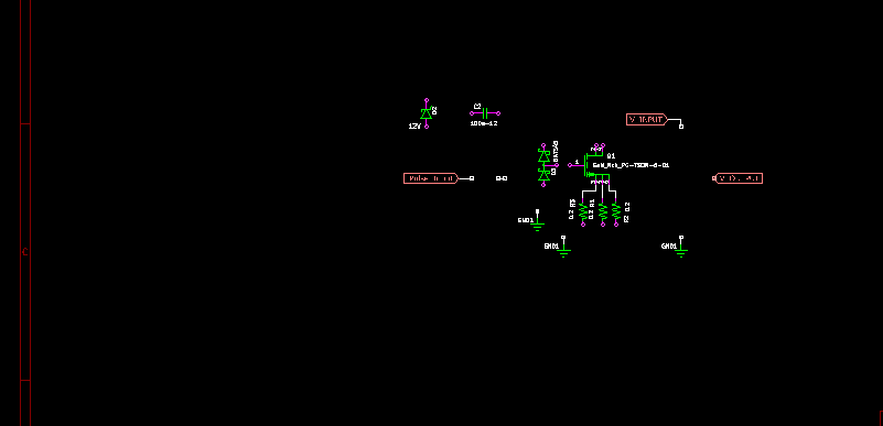

@BobZ
this is your file when i open on accelerated graphics
second Image, same file on Fallback Graphics its working
