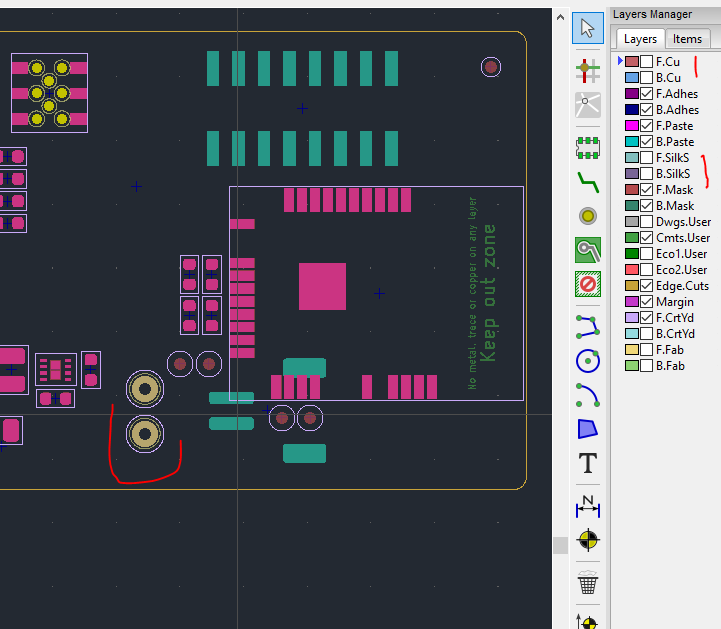

Show through-hole pads without top/bottom layers
Here the view of my board with layers Top, F.SilkS enabled and flag Items > Through Hole Pads checked.
For documentation purposes I want to show the Though Hole Pads, and their numbers/names inside but without the Top (or Bottom) layers.
If I hide them, the Pads also disappear, even if the Items > Through Hole Pads is still checked.

I hide X.Cu and X.SilkS on a board of mine, and it shows THT holes fine as it does pads too (vias get hidden though).

Sorry, latest stable: v5.1.9
Anyway, the trick is to enable the F.Mask layer. Is this one that makes them visible again.
Yep, it behaves the same on my version.
