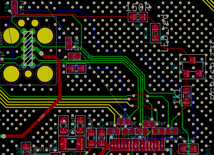

Thanks for you very good and long answer. It makes it a bit easier but still I think an shortcut for changing layer of an selected segment of an track would be a great KICAD feature. Here the screenshot of my pcb. The blue surrounded green tracks have to be changed in layer.
And my answer is still the same:
Do more experiments with the selection tools in KiCad and learn to use them effectively.
Try this: First do a small rectangle selection in the center:
then press u to expand the selection, and follow up with an e to edit track & via propertis, and then set the other layer.
But I also agree that a request for a single keypress to change the layer of a track segment (or an selection) is a valid request. Maybe somthing similar is already implemented in KiCad-nightly V5.99. It has many new functions, and a lot of the new hotkeys have no default key assignment at all because there are just too many of them.
