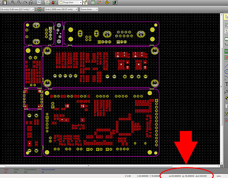

… open KiCAD, navigate to the layout editor and do as you wish… have no frame or a frame with the origin in the centre, frame with the origin at the left bottom corner… all possible.
No need to nag the Dev’s about this. Really.
The only thing you have to live with is that the alignment of the origin is FIXED to the paper you chose as background… so if you are going to print your layout it won’t sit on the paper if you insist on having the origin of your frame/drawing/layout in the centre as it’s fixed to the upper left corner of the paper.
And if you want to draw board outlines to some origin point learn how to use the second set of coordinates in the status bar with the [space] key on you keyboard.
Also good to use the grid and tell your mechanical engineer that you can work to an accuracy of 0.01 mm or 0.1 mils. It’s really no rocket science.
And while you’re talking to the engineer tell him that you can import dxf drawings to be used as outlines/etc. so you can reduce the workload on your end to the one of importing a dxf file.

Open EEschema or PcbNew, go to menu File>Page Settings… in the new dialog navigate to last row at bottom/right, hit [Browse] button and select the page layout file you want.
Voila :smile:
Once you select a new layout the .pro file will be saved and populate the field I mentioned for either eeschma or pcbnew section in that .pro file.
