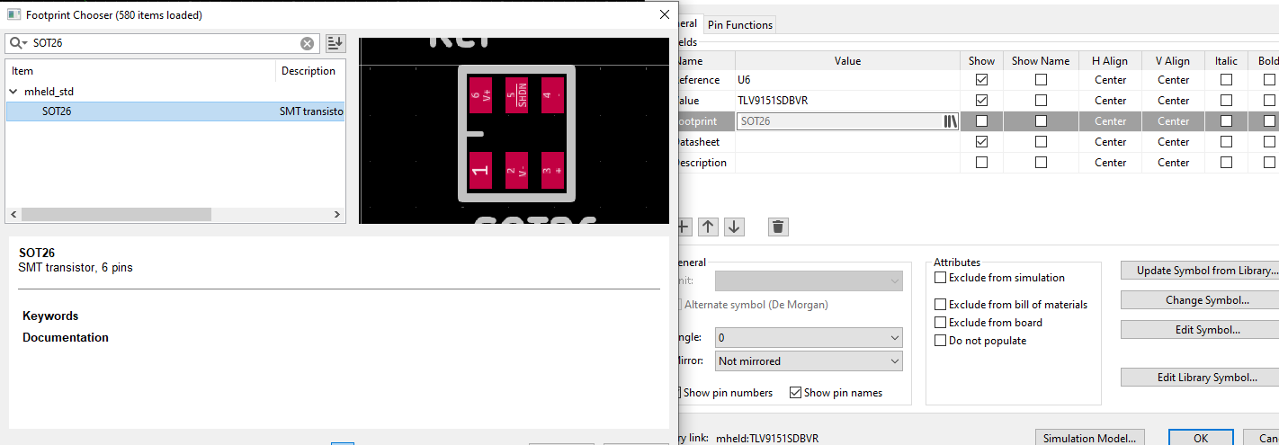

Problem: I open a symbol and then choose a footprint through the symbol dialog. About 75% of the time when I double-click on the desired footprint the dialog window closes without an update to the symbol information. This also occurs if I single-click on the footprint then click OK in the dialog window. This is occurring with both networked and local libraries. This is occurring on multiple installs (Windows 10 as well).

My process is to:
  1. open the symbol properties
  2. click on the Footprint field
  3. Click the icon to open the Footprint Chooser.
  4. Scroll to the desired footprint.
  5. Select the footprint.
    I’ve tried different combinations of double-clicking the footprint name, single-click to ensure the footprint is highlighted followed by either double-clicking the name or selecting ok in the window. The behavior occurs regardless if the footprint field was previously populated. I only noticed this behavior starting in 8.0.3.

Attached is the image showing the steps that I follow.

Your above method is the normal for assigning footprints via the properties manager. Unfortunately, I have never experienced your problem either.
Maybe try using Tools > Assign Footprints to see if the problem still exists. If it does, try to see if the problem is with network, local or both.
I have also not seen this problem myself. I also do not use network drives and have seen multiple bugs around these things.

I am seeing this exact same behavior. When editing a schematic symbol, I assign the footprint quite often from the selection field. I have seen this in 2 different projects, in both linux and in windows, both updated to 8.0.3. In this example, when I click the library to bring up the dialog (next to SOT26 in this case), and double click SOT26 so that it should read mheld_std:SOT26, it just goes back to ā€œSOT26ā€ (without library specification). Repeating a second time made it work. I tried various iterations of having it start with a library specification (e.g. ā€œmheld_std:SOT26ā€), without, with completely invalid footprint names (ā€œSOTBLEEā€ and ā€œmheld_std:SOTBLEEā€), and it was still about 50% hit or miss, with no real reason or indication as to why the field wasn’t getting copied over.
