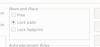

If you select a Footprint, and hit ā€˜eā€™ -dit, then in the middle of the popup properties there is a:
For your TO220 the radiobutton is probably set to ā€œFreeā€.
Normally itā€™s set to ā€œLock Padsā€, (Which is relative to the Footprint) and if you then highlight a single pad and hit ā€˜mā€™ for move, Pcbnew selects the whole footprint and moves it.
If youā€™ve accidentally moved a single pad in a footprint and Undo [Ctrl + Z] does not work for you, then simply select the footprint, ā€˜eā€™-dit and:

Your comments are helpfulā€¦however I am puzzled because my footprint is set to ā€œLock Padsā€. I have checked both my latest file as well as the previous version.

Before posting I did 5 to 10 minutes of experiments in My KiCad V5.1.0, and I verified:
1). Select a pad of a Footprint (only pad hights).
2). Press ā€˜eā€™-dit and you edit the properties of that pad Hit [Esc] / Cancel to go back.
3). Select a pad of another Footprint.
4). Press ā€˜mā€™-ove and the whole Footprint gets selected and can be moved.
x). Experiment with the ā€œmove and Placeā€ / Free setting, and confirm that then a single pad is moved.

Yes your observations appear to be correct. However I did not want to use ā€œmoveā€ command. Rather I wanted to use properties to specify precise Y position, and that ended up pad properties (and re-positioned only the pad as a result.)
