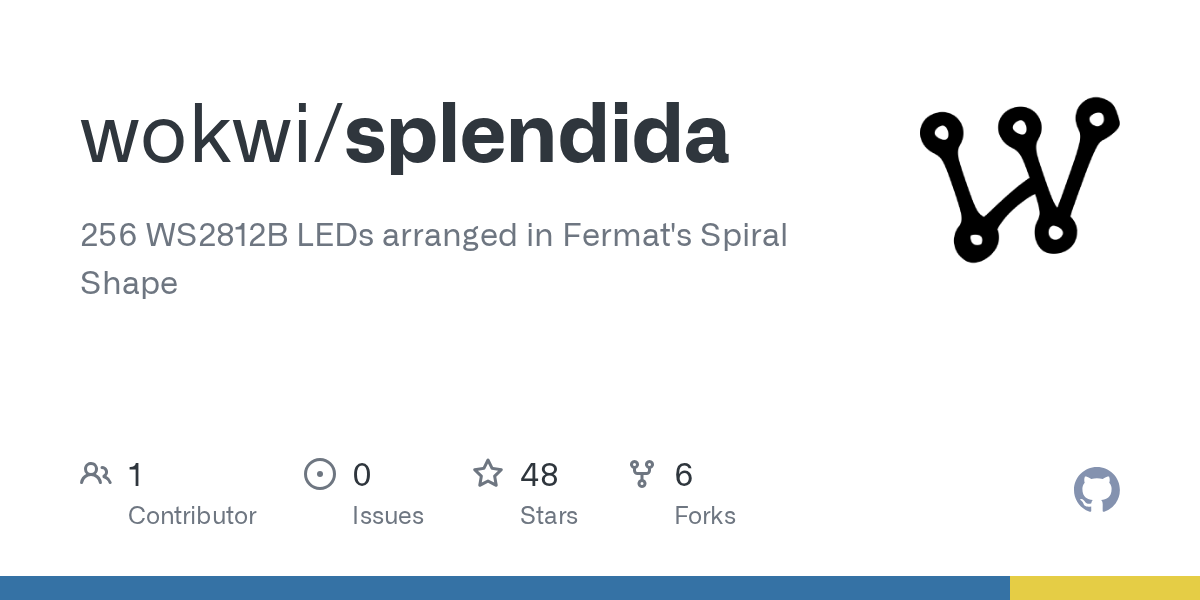

Would you be interested in this board?
256 WS2812B LEDs arranged in Fermat’s Spiral layout, under CC-BY license:
Gosh I need to squint just looking at this photo. I suppose you think it is a bright idea? How many watts is it? :slight_smile:
Which v5.99/v6 new features this demonstrates?
bright idea
Nice pun! Full brightness is ~75 watts (60ma / LED * 256), but I guess it won’t last for long unless you use Aluminum core PCB
Nothing too fancy, though I have a version with some Fillet Track just for the sake of art :slight_smile:
It may be a good way to showcase KiCad’s scriptability, since most of the schematic and the design was generated by Python scripts (which I’m happy to contribute as well)

If you want to take a look, I published everything on GitHub: the board schematic and layout, and the two scripts that aided me in creating them:
It’s only a single layer of tracks, and no via’s. The PCB’s are also difficult to solder because the heat gets sucked into the aluminimum.
Good point about the solderability, I haven’t thought about that. As for the layers, I actually found some mfgs produce 2-layer boards (e.g. PCBWay). So I guess it’s only a matter of paying enough :slight_smile:
