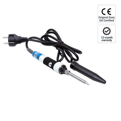

Since many years I am using such iron:
but I am not using it extensively.
