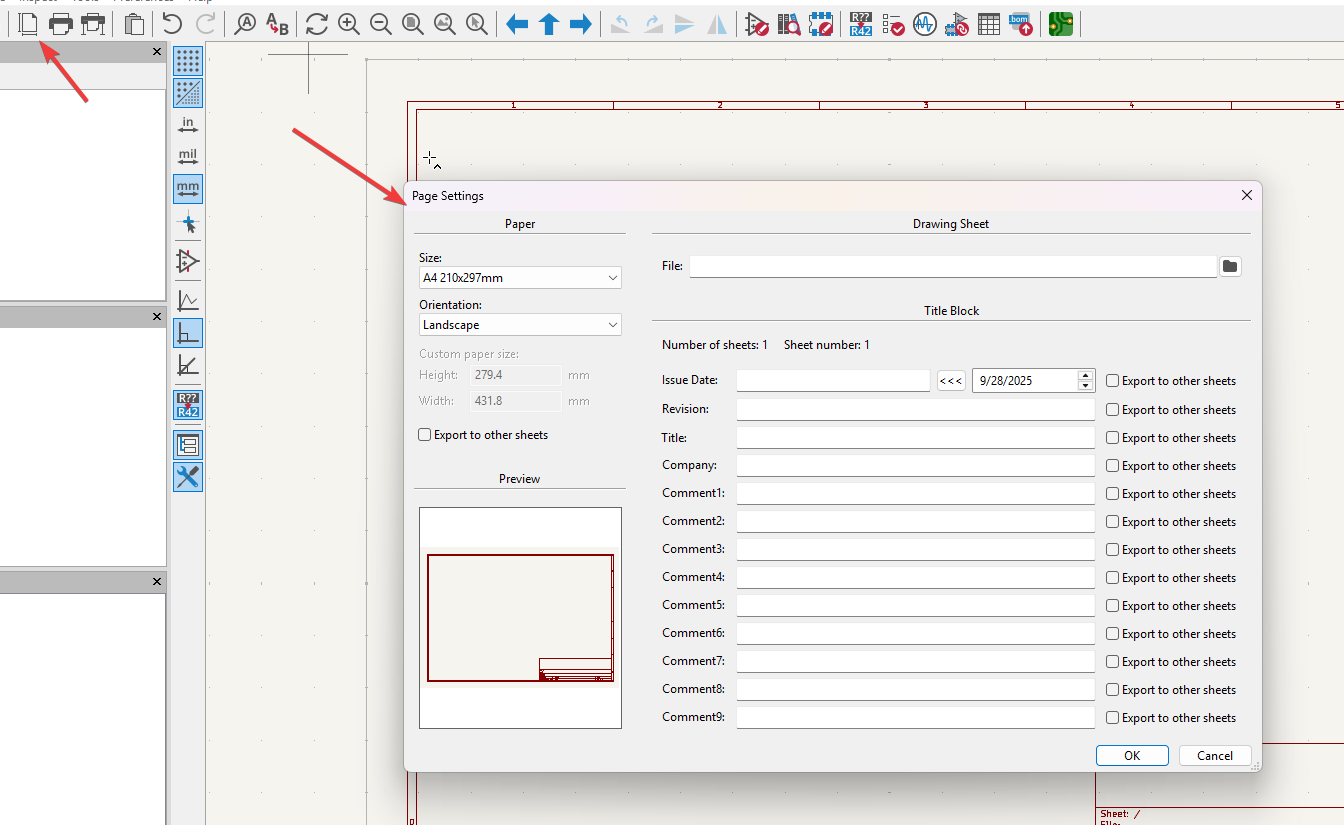

Hi everybody !
I am a new user if KiCad .. It seems a very good software, not expensive like prof-softwares and very powerfull !
I succeed to make a schematic with several devices. It works fine, better than my old previous software (Isis Lite).
However, I am a bit disapointed when I printed the schematic (A4). The borderlines are ok on the sheet but the devices are very small, It’s difficult to read the pins number for example.
I think I prefer less devices on a sheet, but easier to read !
Is there a way to setup the zoom on the printed page ?
Many thanks for your tips.

Easiest is selecting a smaller paper size, eg, A5 instead of A4.
I have created a “simple” page layout (simple.kicad_wks) and in that I have removed the whole double border line and shrunk the title block. As a result you can still put a reasonable amount of schematic on an A5 sheet, and then “zoom to fit” while printing. A similar option is to stay with an A4 sheet, but then scale it to fit on two pages and glue them together after printing.

Just draw the schematic on A5 and print/plot on A4. No reason for the Photoshop round trip.
You can change the page setting at any time, even after drawing circuits. You may have to move the circuit afterwards but its easy.
Ok that works fine ! My apologize ! So I set a custom size and print in A4 mode. Very fine.

I did tests with several sizes of printing. Now I work in user size 11000 x 7700 and print in A4. It’s ok for my 70’s eyes !
