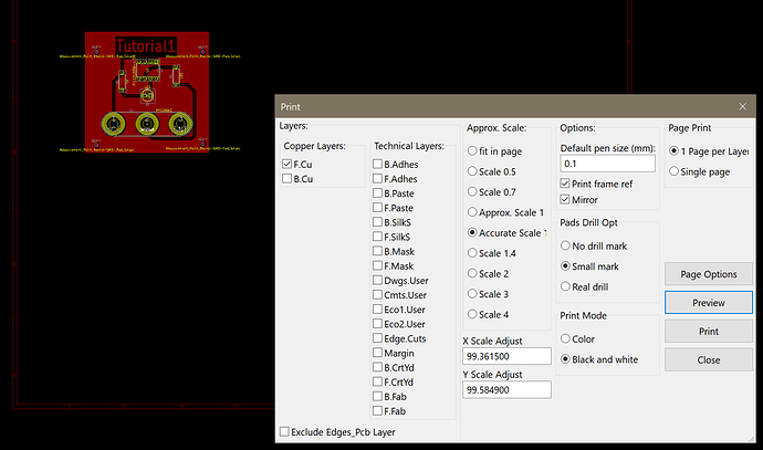

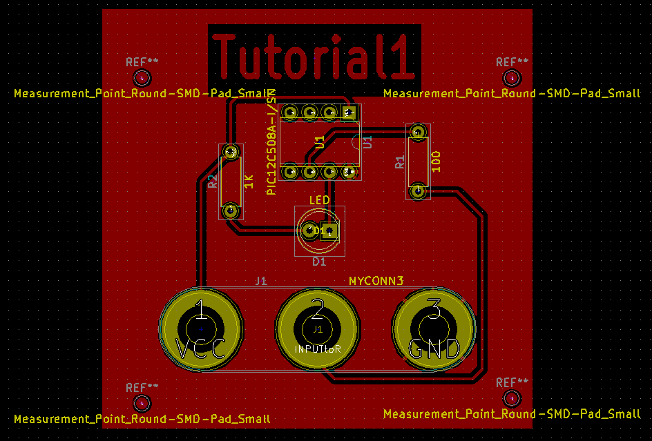

I have a completed PCB layout
and wish top print an image of it for toner transfer. My first printout works okay, and I calculate the necessary percentage adjustment for the printer to get the image to the required actual size.
I enter the percentages
and print that - and I get a blank sheet.
Where did the image go?

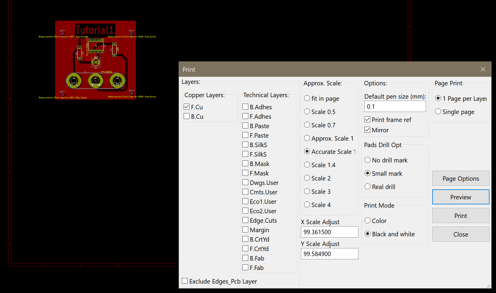

Do you see it in the preview?
What was the settings for the test-print - fit in page?

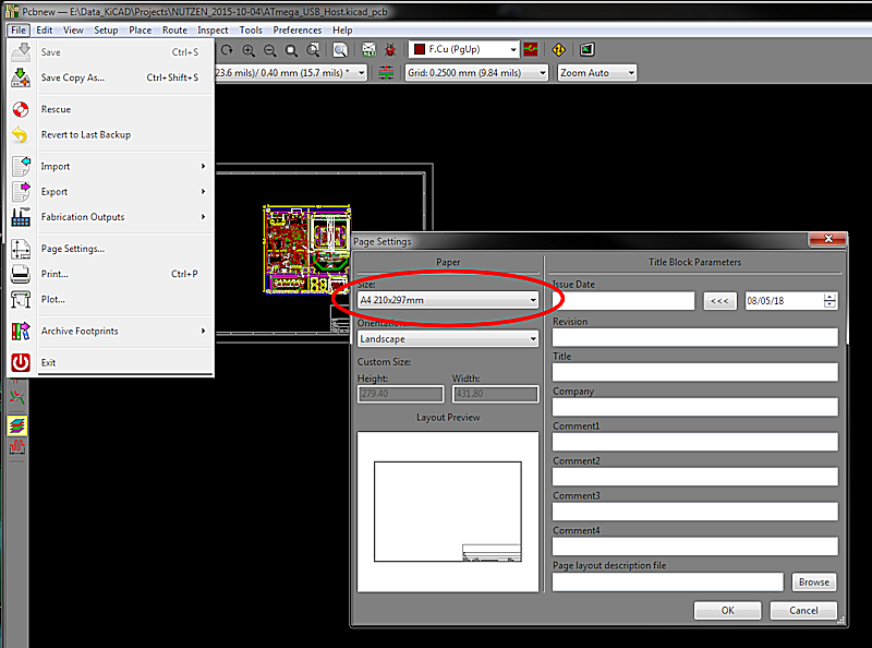

What paper size did you set in the layout editor?
Does it match the printer paper size?
Yes Joan. All that is normal.
Have you tried xScale 0.993615 and yScale 0.995849 yet?
Those are fractions, not percent.
I was just about to post that. Yes, that was the mistake I made. Changed to decimal factions and printed okay.
