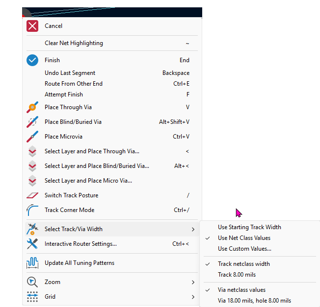

I have defined a Rule Area (Zone) and Custom Rule to constraint track width passing through this Zone.
When Routing interactively, how can I force the track with to obey my Custom Rule ?
Would it make sense it picks the Track width from the Custom Rule automatically ?
I know my Custom Rule is working, because if I route with a different track width than what is specified in my Custom Rule, DRC will report it.
I don’t even have a choice to pick from Custom Rule

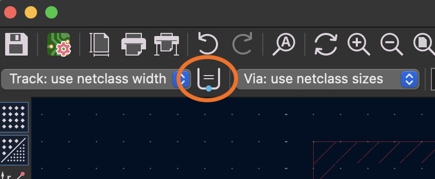

Make sure this button isn’t enabled:
Does’n make a difference, still not working …
