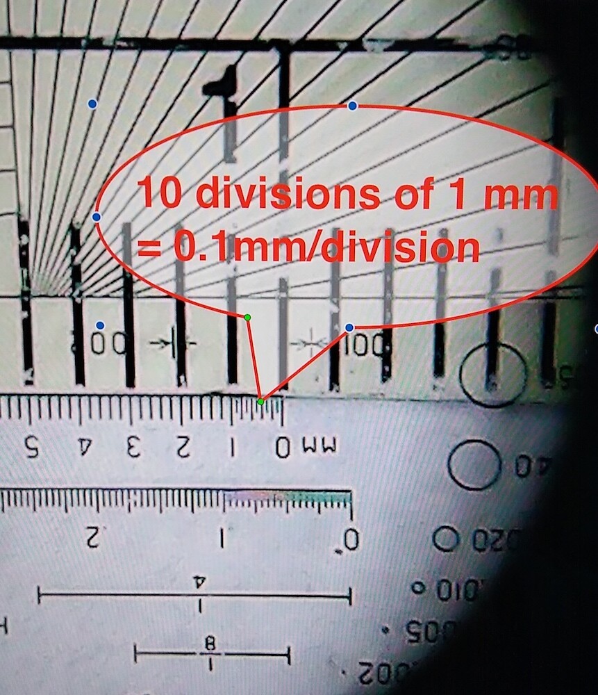

My HomeMade Optical Comparator:

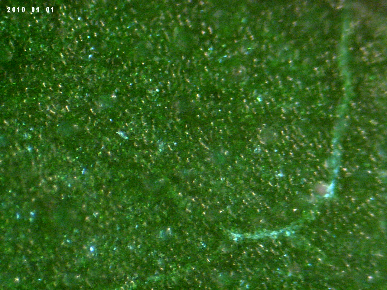

A few years ago I was debugging a PCB problem that required using Microscope to reveal Short Circuit. I discovered a Fragment (microscope photo). That led to the next-step of making a HomeMade Optical Comparator, as follows:
For Magnification and Dimensional Inspection, I used a Printer’s Loupe with Gratings and 3D-Printed a Housing to hold a $10 webcam.
(I accidentally broke the webcam so, just ordered a new one (photo)).
With the Loupe placed into housing and adjusted, you can see very good resolution and fairly accurate dimension inspection, verified with micrometer and caliper…
Burr between two Pads
Metal String Under PCB Coating
Opt Comparator without Camera
Printers Loupe Gratings
In Use
Housing designed to use this/similar Camera
You are lucky it’s outside/under and visible.
Once I had a case where there was a conducting connection INSIDE a two layer FR2 pcb.
Every single component was removed one by one to find that bugger.
