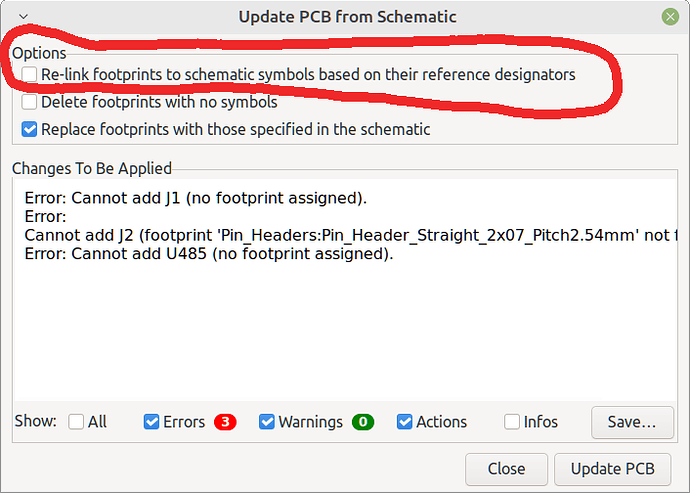

In my case the source of the problem was clear. I had the “Reset Existing Annotations” check box ticked from earlier on, so when I updated the pcb from schematic it first reannotated everything. When this was subsequently loaded into the pcb editor it made a complete mess of everything - a part that was previously C4 say became a different capacitor somewhere else, so all of the connections and everything was completely wrong. It was so bad, I’m sure my blood pressure spiked pretty high that day.
I couldn’t/didn’t CRTL-Z back because I’d made quite a few changes to the schematic, so while I might have been able to revert the pcb, the schematic was not going to be that easy. In the end I used an autosave.

That is not a problem at all. re-annotation on itself does not break the project, because normally KiCad uses (invisible to the user) UUID’s to track the connections between symbols on the schematic and footprints on the PCB. Nearly always the real problem here is the Re-link footprints to schematic symbols based on their reference designators. That option should (nearly) always be OFF. It should only be on (once!) in some special cases, such as re-synchronizing the PCB with the schematic when both are imported from some external source.
Just had a look - this option is indeed on. Not sure when it was turned on, or why it didn’t make any difference any of the other times I subsequently used the “update pcb from schematic” function after my issue. However I’ll keep an eye out for it in future.

As long as both the RefDes and the UUID’s map symbols to footprints in the same way, you don’t see any problems with Update PCB from Schematic [F8]. But if you re-annotate the schematic and the update the PCB while the re-annotate is on. You change all connections. Symbols with the new RefDes get connected to footprints with the old RefDes. And this will definitely create a big mess in your project.
Sometimes I wonder whether it would be better if this checkbox was cleared automatically each time the dialog is opened, or at least each time KiCad is restarted. This reduces the chance on errors, while effect on real use is very small. Normally it’s used only once to repair a broken project. Maybe it can be run a few times after each other when there are problems with repairing a project.

That is all. Because it preserves everything else (including connection to the footprint on the PCB, location of text strings in the schematic and more, there is no need to repair anything either. At some future point you will have to Update PCB from Schematic [F8], but there is no need to do that often. KiCad just treats the Schematic (inclusive the UUID’s, RefDes, Values, etc) as the reference, and from there information propagates to the PCB.
