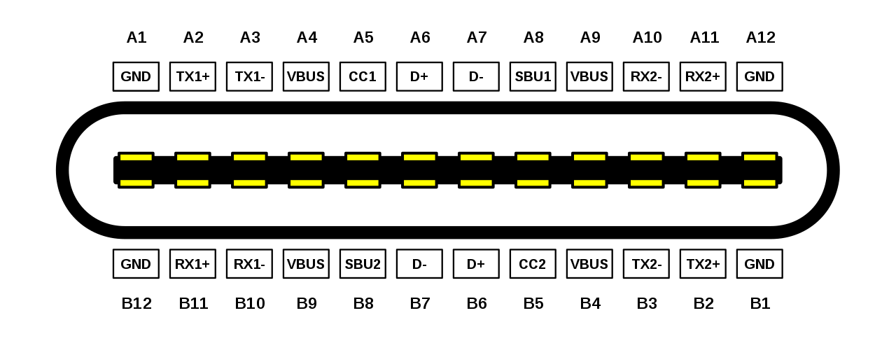

For a project in mind I am planning on replacing a USB micro B type receptable with USB C receptable. After trolling the internet I came across a solution proposed in Reddit. I don’t know if any of you guys have any experience in this. I would appreciate if you can have a look at my schematic and let me know if what I am doing is correct or wrong.

The cables are what they are, the values and pull-up/pull-down direction of the two CC R’s is critical. Be sure you get them right. See for example https://community.cypress.com/docs/DOC-10779, http://ww1.microchip.com/downloads/en/appnotes/00001953a.pdf, https://electronics.stackexchange.com/questions/291413/usb-c-to-usb-a-pinout etc…

USB2.0 Designs on Type-C
Supporting Type-C from an existing USB2.0 design is straightforward and cheap (except for the connector). Basically you tie the DP pins together, tie the DM pins together, and add one pull-down resistor to each CC pin. This new Type-C device will identify as a data and power sink, use the default USB2.0 power of 500 mA, and work in either orientation of the plug.

Your original schematic looks fine according to my understanding. What (if anything) have you changed?
I have not changed much apart from adding diodes and a fuse for surge protection. I believe the main challenge is routing 90 ohm diff pair keeping the length of the short circuited S1+ D2+ and D1- and D2- the same.
