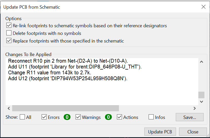

Other problem seems to be when I renumber them I have to place them back into position, which is a huge hassle since the layout has already been done…seems there is nothing I can do but redo a lot of the layout again, or is there some option to keep them in the same position I am missing?

What options are you selecting when you update PCB from schematic after renumbering a symbol? Show us the popup.
Got a little busy with other work this week - finally getting back to this. Here are the options I am using;
Generally you should not be using option 1. Re-link footprints … and you should turn on 2. Delete footprints …
