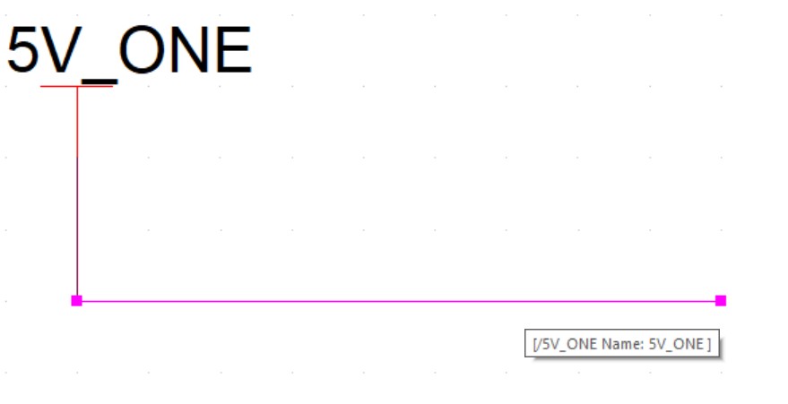

I did a quick search and did not find this, but it may be something I just am missing, but I want to rename a ground net. I know there are the different grounds available like (GND, GNDA, etc.) but if I attempt to change that to say 5V_RTN, or 3V 3_RTN I cannot it says “Power Symbol value field text cannot be changed”. is this possible? Doing so greatly helps when you have numerous power rails that each have to be isolated.

Instead of changing the value field, create new power symbols.
Renaming the field is not enough. The name of the net comes from the name of the pin. So, in the symbol editor, edit the pin and change the pin name.
The pin is a little invisible circle, usually at (0,0).
So if I had 6 isolated power rails I have to generate 6 new symbols. Man this is just painful.
Since I am still semi-new to KiCAD, you comment made me look at the Voltage Symbols. Those are the same way so if we need to change the name of a power rail we need a NEW symbol to. Ever other schematic tool ties that name to the net name of the pin.
There is a no power symbol option: use labels.
A power symbol can be seen as a global label.
I guess that is a work around, but deviates from your typical method of documentation of a design. (IMO). Every schematic I have looked at or done there is a Power symbol with the “net” name assigned to it. In Eagle, OrCAD and Altium, there is a generic power symbol that oyu can change the name to and that changes the net that is tied to the pin. Never had I had to generate a “new” symbol for each power or ground rail.
Example:
In OrCAD, two rails, same symbols all I did was chage the symbol label, and the net on the connected wire changed. less than 10 second change.
